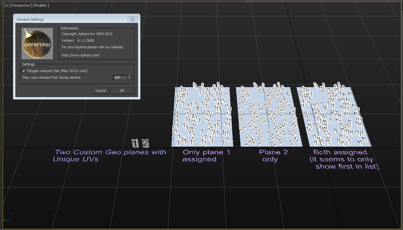

Hello -
I am trying to create planes with a random distibution. I created an example scene which is attached. It seems that the "Seed" function is not working in my file. Only the first mesh in the list is being used. Either mesh will work if its the top of the list, or assigned alone, but when both are assigned only the first gets used, I tried switching up the order and only the first is used. Will be very cool if this can work. Hopefully its just user errror from me. Using 4.1.2.5686 I actually updated from 3.0 hoping that was the issue. :)

Thank you for the report and apologies for the delay. I will look into this and let you know. Marsel Khadiyev (Software Developer, EPHERE Inc.) | |

This is fixed for the next build, thanks again. Marsel Khadiyev (Software Developer, EPHERE Inc.) | |
