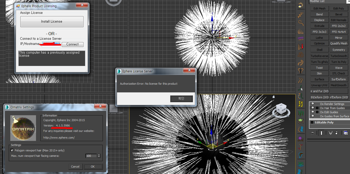

After receiving the upgrade was the installation. (win64__342031352033343632.msi)
But Assign License Error
Turn off firewallsTurn off Norton Anti-Virus
Restart the local services
Reset License (https://www.ephere.com/plugins/autodesk/max/ornatrix/licensing.html)
I tried everything.
Why not licensed certification?
plz Let me solve!!!
Are you connecting to localhost (127.0.0.1) for your licenses, or a differen computer? What happens when you press "Install License"?
same Problem with 3dsmax 2013 Win7 and license Ornatrix-3dsmax-4-5-5-8275-win64_342031352038363330.msi.
Trying to install the license results:
This computer has a previously assigned license
thanks for help
Please follow the instructions found in the following link to release your licenses and reinstall Ornatrix:
https://ephere.com/docs/Moving_Licenses_Between_Computers.html
