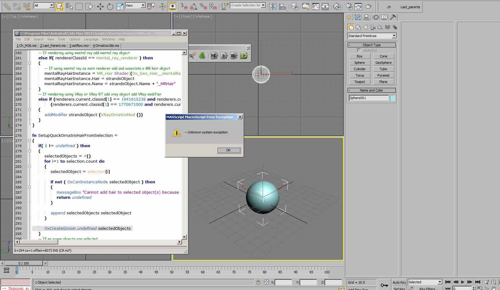

  I noticed : when i make Create/Add Hair in the menu, if i am in direct3D mode, i have this message from maxscript and nothing more happen. no crash, but no hairs.
edit : I can see in "display drivers" that the version of direct3D is 9.0, not 11. But in the DxDiag, it is directX 11 which is installed. Is it normal ?
I just tried Direct 3d and OpenGL rendering models on 3dsmax 2012 (x64) here and both display the hair fine. I only have Direct3d 9 option however, not 11 here. Does it also fail for you in OpenGL mode?
