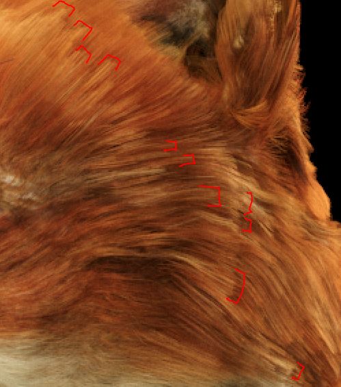

I have a problem with the zbrush exportet curves in ornatrix which i cant handle yet.
my stack looks like this:

Now when i render it with a VrayHairMtl i always get a kind of block look to the strands.As i have a bad distribution of the hairs or a bad interpolation,

no matter which method i use,i always get a pattern like Effect in the hair.-> See Attchament.
Hi Daniel,
Are those red marks the tips of the hair? if so, it looks like the splines you used for this hair are inverted.

but those red marks were painted to show the blocky look on the hair.
i now fixed it by using the length mod with randomness :-)
