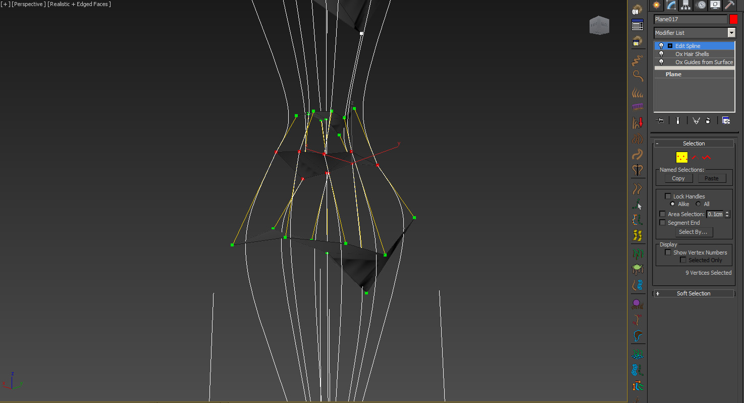

| Hey Michael, Here is a slighty related issue that occurs when an edit spline modifier is added on top of a stack using the ox Hair Shells modifier. While the results of the Hair Shells modifier are linear in nature (correct?), adding an edit spline modifier returns different results (where knots would be expected, bezier handles are placed every other knot... kind of :) ) (see attached image knots.jpg) I've included a scene to demonstrate this (max 2014 Ox 4.3.5.7457). Hope it makes some sense :) Cheers, Tim |
| Thanks Tim, I am having a look at these and will get back to you shortly. Thanks again Michael |
