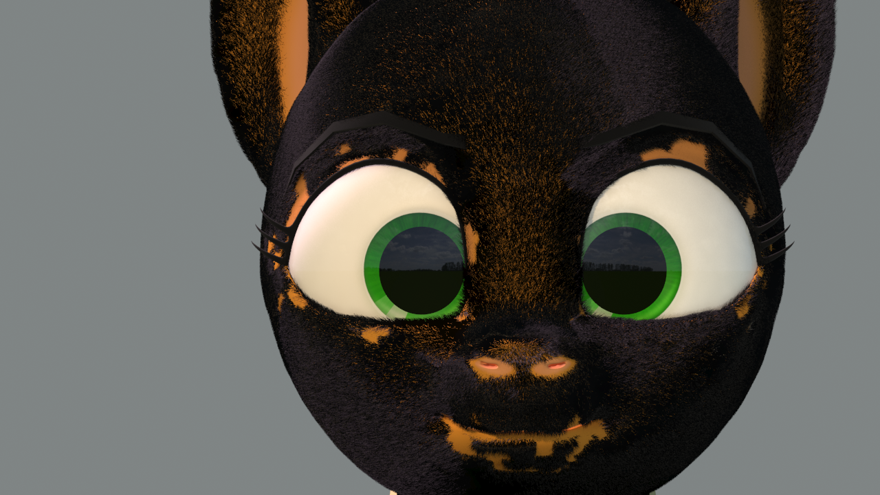

Hi, I have a problem with some coverage and tried for days to fix it. The hair seems to be creating patchy areas when rendering (vray) any help as to why this is happening would be greatly appreciated :)
Looks like you might need to use the UV option for hair generation. If you post your file I can have a look too.
Thanks for the reply. I tried that and got pretty much the same result :( Here is the file anyhow.
>Character.rar (838515 bytes),
Any luck? I feel as if I've tried everything, I have no idea what the problem could be :S
Does the character have UV's too?
Yeah, maybe not the best but they're there I did do a quick planar map to see if anything change but it didn't look like it had.
It looks very much like a UV issue where Use UVs Coords in Hair from Guides needs to be used. You need to have a properly unwrapped character for that. Planar map would not do the trick. Once mapped you will need to update your stack.
I'll try to give it some proper UV's, I didn't really bother as it was pretty much just one colour. How would I go about updating the stack?
You were right! I re-did my UV's (found a few part overlapping too) reapplied Ornatrix, ticked the use UV's and it worked :D
