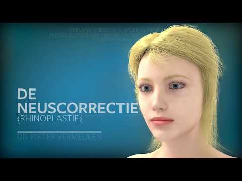

Hi folks, i've been tweaking and rendering and tweaking some more and i think i need a hand.
This is an animation where i want blonde smooth silky hair, instead i get straw dry hair.
I also want to include a braid of some kind but i need to figure the smoothness out first.
Any tips are more than welcome.
https://youtu.be/Tc-9t2TIaws
Thanks Kurt

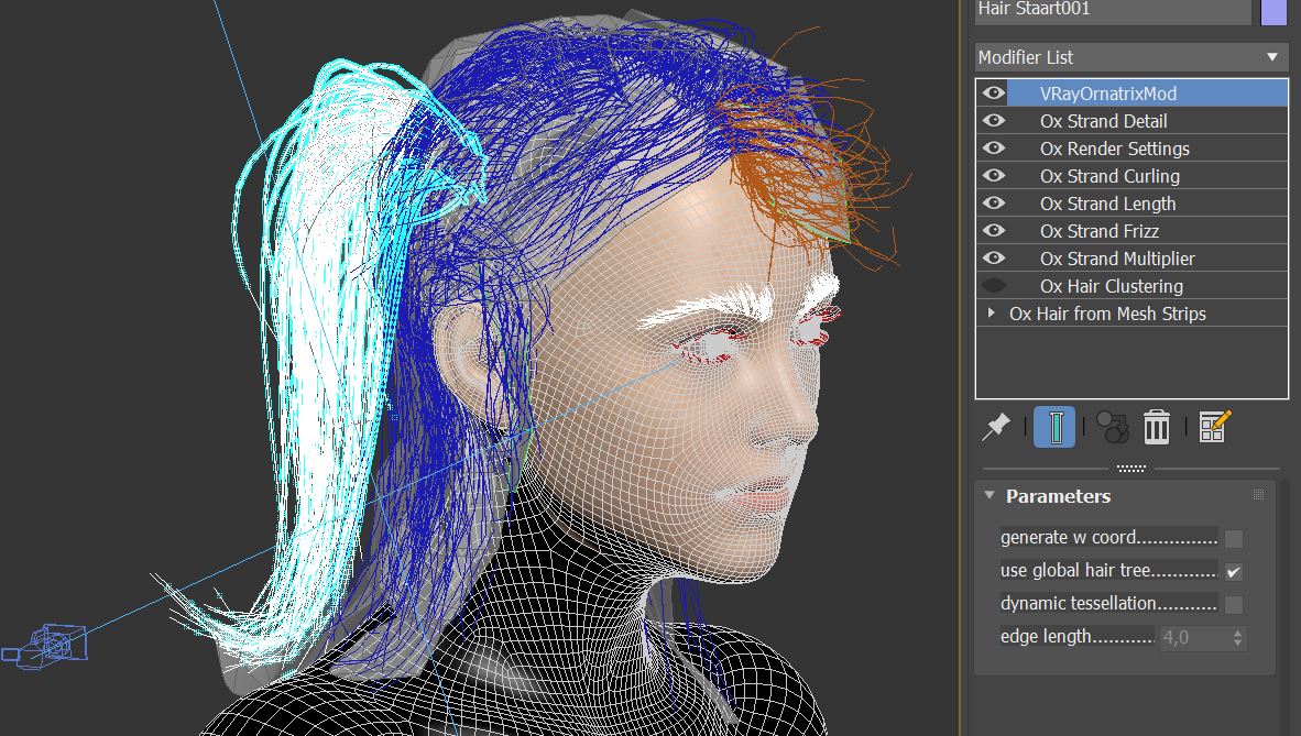

Hi Kurt,
Looks like you are using too much frizz on the hair. If you are using a Frizz modifier use lower values, you can also try using a StrandClustering or HairClustering modifier to add some clumping. Could be helpful if you share a screeshot of your modifier stack so have a better idea of whats going on.
Hi there Jeodarnis,
The pony tail has some frizz but not the rest it seems.
I will strat trying a bunch of things to smoothen the hair.
If you see anything dodgy feel free to let me know please ;)
Try turning off each modifier one by one starting from the top to see how they are effecting the hair. I see you have a Curl modifier in there, I think this is the cause of the proble. Try turning it off.
Thank you i'll give it a go!
