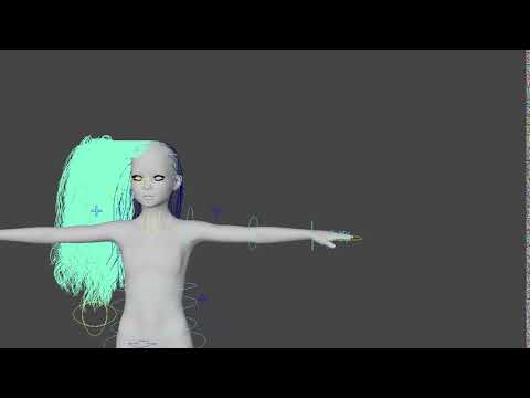

So I've been trying to test the AdoptExternalGuides node and while it seems to get the job done as far as deforming a groom, it seems to offset my groom by a lot. This seems to only occur with my rigs, if I were to try this with a regular Poly Spere, it would simulate and deform perfectly. Here, I'll show a playblast

The video is not available, can you please reupload it? From what I understand this may be a double transform issue, which can be solved by parenting the hair objects transforms in the right way.

Yes, you were right, it was a double transform. Also, thank you very much for the solution. I'm very fond of the AdoptExternalGuides feature, makes simulation much more pleasant. Underrated feature
