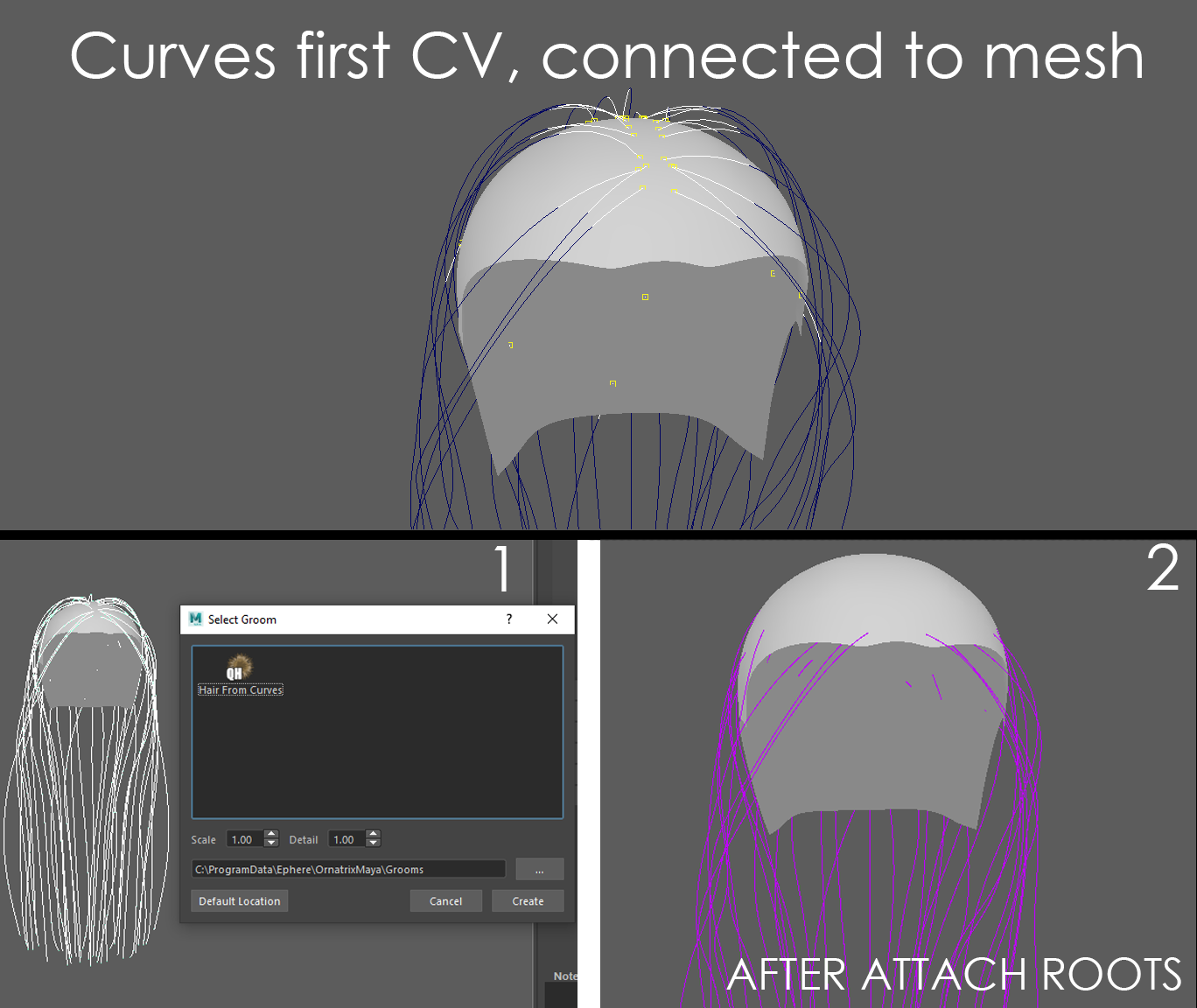

Ornatrix Curves Error?
Posted by:ManiSalguero
Data created:11 February 2019
Hi, I have some problems with ornatrix and curves, in the moment that I create hair from curves, It works, but when I attach to the base, it's going down, hair change the position.
(first cv of curves are connected)
Make sure that the CVs touching the mesh are the roots of the curves, not the tips. If that is not the problem, try deleting the transforms of the curves.
