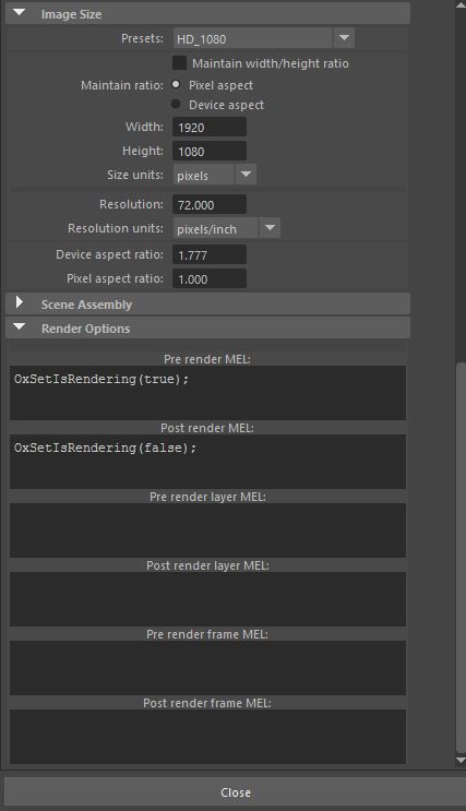

Please open the Render Settings window, expand Render Options in the first tab (Common), and check the Pre render MEL and Post render MEL fields.
Should be
OxSetIsRendering(true);
and
OxSetIsRendering(false);
If they're not, make them.
If you create a fresh scene and add hair to an object (and Arnold is your current renderer), these fields should be set automatically. It looks like you have just the Pre-render script but not the Post-render one. I don't know how could have that happened.
Thank you Ivan, I have attached an image of exactly the thing you mentioned in the Render Options tab (Common)

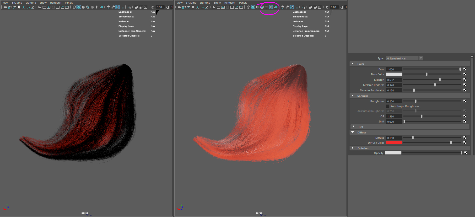

Also, one other problem arised recently, when connecting the shader (aiStandardHair) to the hair I noticed in the viewport it looks red and black instead of pure red as I want it. Do you have any ideas what could be causing this issue?
The left image shows the hair with the attached shader in the viewport and the right image looks better but I have to activate the Use all Lights  to see the hair without the black strands.
I have attached an image for better representation.

About the shader issue you may try the second workaround I described above, switch hair display mode to Legacy. This way we may know if it is related to the new optimized display mode.
