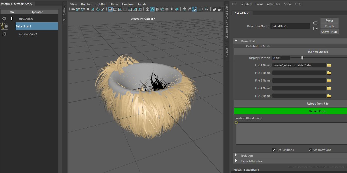

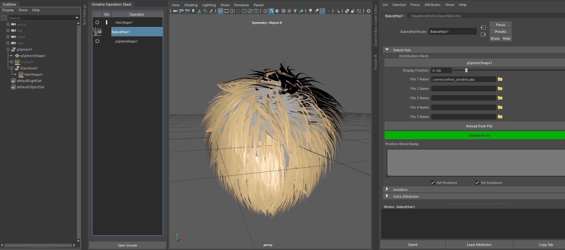

Hi I am trying to attach a baked groom, exported with ornatrix alembic plugin.
and imported again in the same scene.

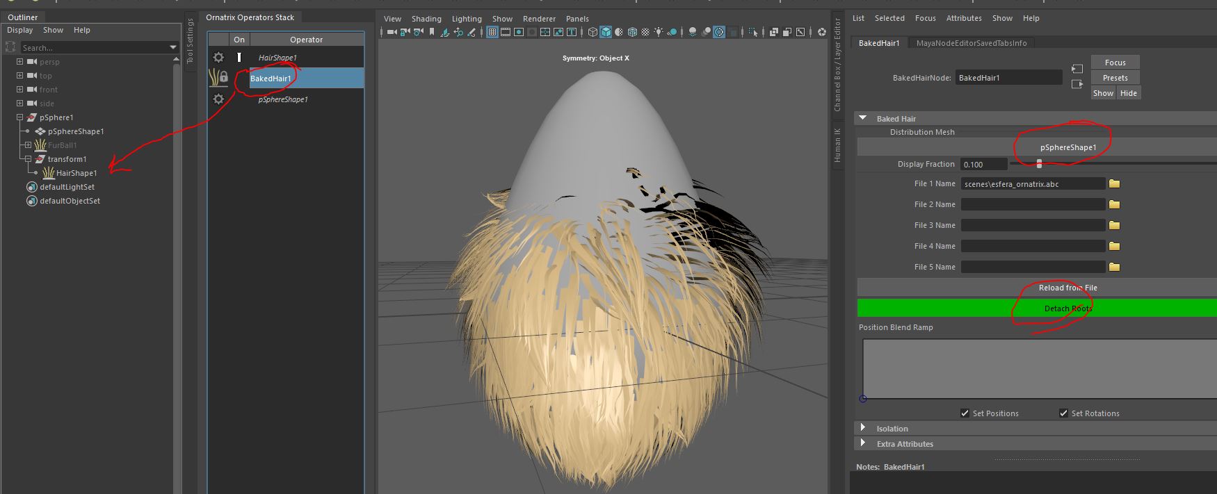

I setup the distribution mesh, the same mesh I used to create my groom.
I attach the roots.... but it does not follow the deformations.

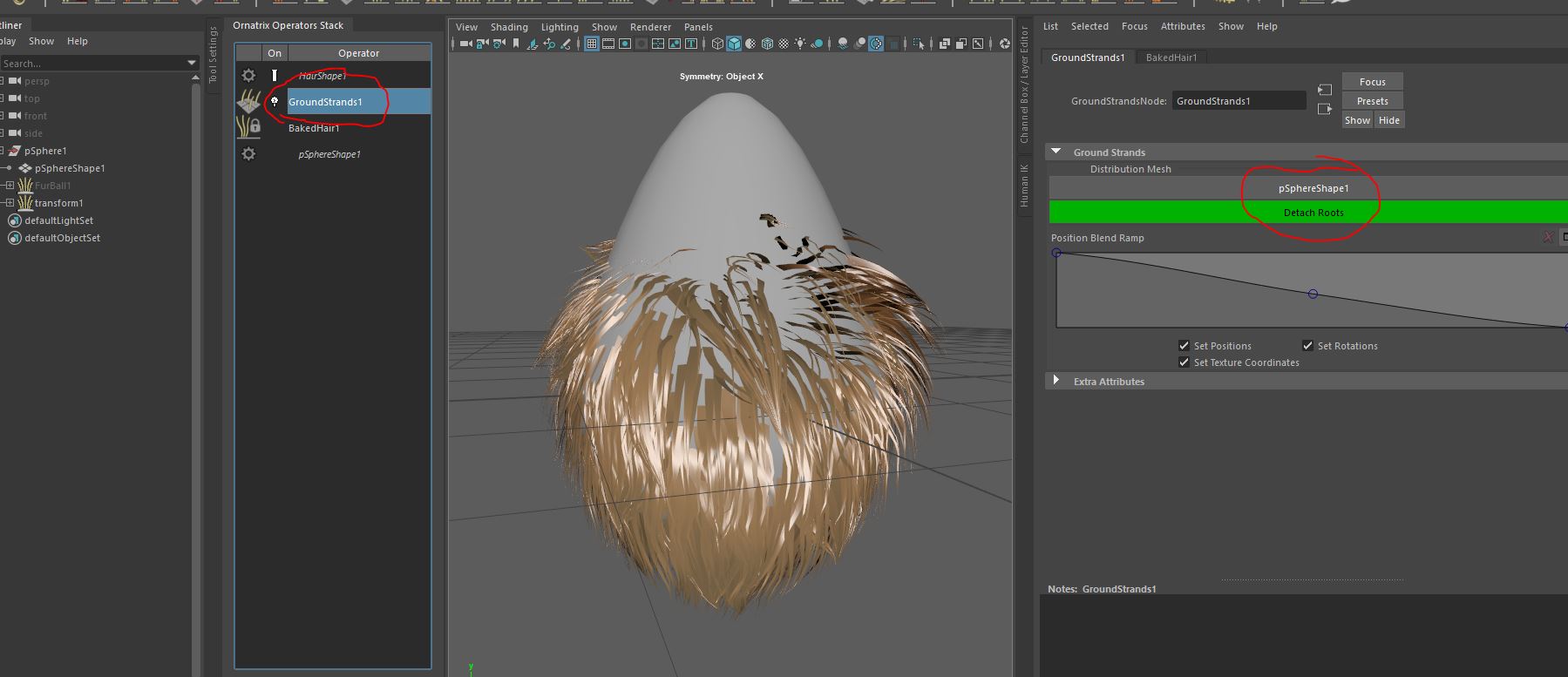

I try to use the "Add Ground Strand" operator, but it does not work.
tested with Ornatrix 2.3.8.19987  and   2.3.8.19783
Did I do something wrong?

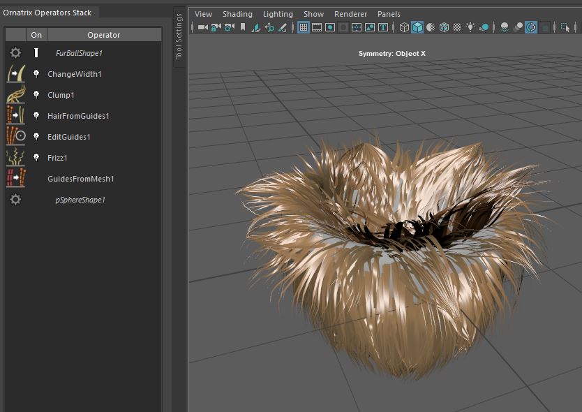

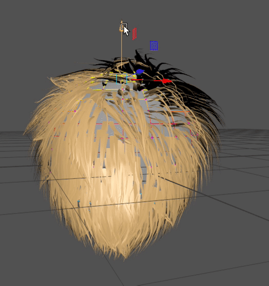

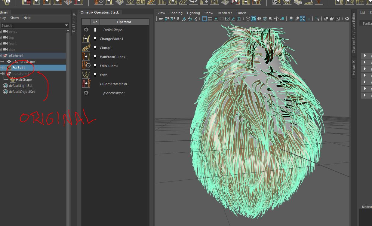

Hi, I have tested that new version... but it does not work 100%.
now it follows the geometry, but does not rotate right.
Attched two images, original vs baked version (alembic).
thanks for your support
I see. We are looking into this.
