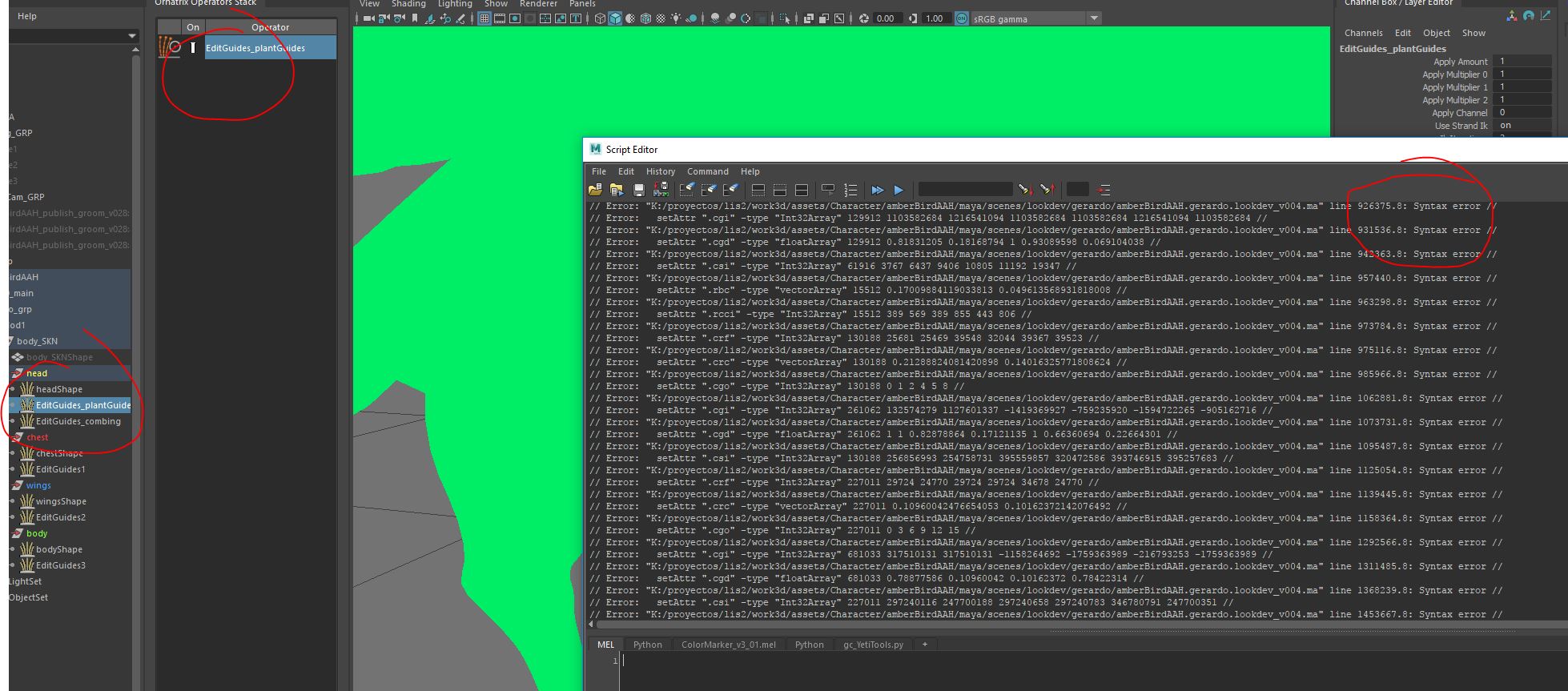

We have a lot of problems with the new 2.4.0.20213 when we open old files, it says sytaxis error, open the scene, but it is corrupt... lost all ornatrix nodes.

sometime files .ma are not saved right. it does not show any error message. but if you want to open it later, those files are corrupts... you can still work after save it, it seems right, but you gonna lose all your works if you save it as .ma..... very dangerous.
I can't see a problem in the picture of the log.
Please at least provide the contents of the Script Editor as text (not a picture), or better provide the corrupt scene itself.
