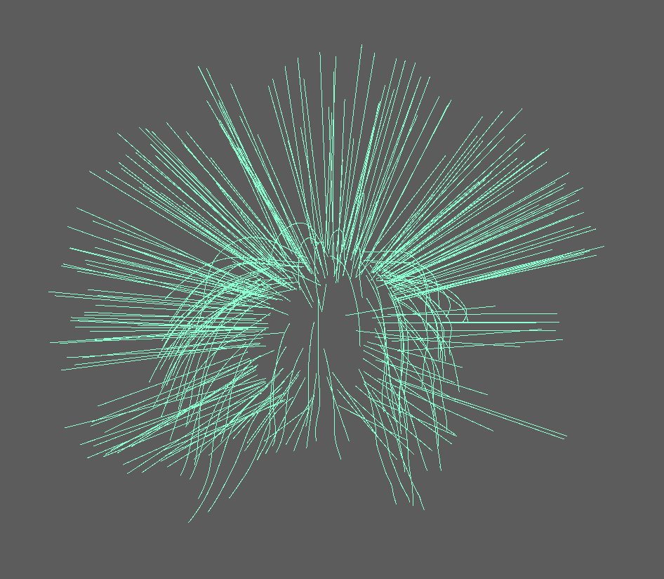

I tried to find more about this in the forums before posting but couldnt find anything concrete-  I notice that when I create hair grooms, and then update to the latest version of ornatrix for Maya, I open up those previous grooms and there are guides that are how I styled them, but a whole set of grooms that are sticking straight out.
My question is is there a way to preserve my original hair groom before the update? Are there tools within the guides operator menu to help me retain all my previous work done with older versions of Ornatrix?

This is not expected. Do you remember the exact build where you created the groom? What build are you using right now?
Yes, the original hair grooms in our system were created with this build:  2.3.8.19783 (11 June).
They have worked in our renderfarm on that build.  When I updated to recent builds and opened the older files created from this build, half of the guides appear straight out and not affected by any of the guide operators.  Please let me know if you need any more information.  I am running Maya 2018 and have been since last year.

And the guides are broken in 2.4.0.20213?
I cannot reproduce this issue. I tried creating a groom in 2.3.8.19783, planted some guides and comb them. Then installed the latest stable and the scene loads fine. Can you share the problematic scene for testing (only the hair)?
Hello Jeordanis,
Attached is one of our hair grooms tied to a skull cap with a transparent material on it.  When you click on the "edit guides" stack operator, you will see guides that conform to the hair style, there are others that remain straight out in space.  I can still manipulate them, but I have been told by my co-worker that all of our previous grooms behave this way when created on a build previous to the latest v2.4.0.

Thank you Jeordanis-  Here is another one of the most recent grooms I have created - saved both .ma and .mb for you to look at.  This groom was created last month and the version I updated to was 2.3.8.19783.  I opened this one today and it appeared the same.  When edit guides is turned on, the adjusted guides show, but are surrounded by guides that are extended/unaffected.

Jeordanis, I have done some troubleshooting on my side and found a couple of things that might help:
- The bug does not happen to all grooms, but most of them that have been physically combed downward and not been procedurally brought downward by gravity or surface combing are affected.
- The bug seems to add guides over the hair groom - when I delete the ones sticking out using edit guides, the hair style is still underneath.
Would you happen to know why unstyled guides would be added to a scene?  I will keep trying to debug...

the stack is broken beyond repair, the operators are not connected to each other properly, the top HairShape is connected directly to the GuidesFromMesh node instead of the node that is at the top of the stack.
I don't know how has this happened, I don't think it can happen easily by "normal" use, and definitely not just by loading an older scene into a newer version of the plugin.
Yes, we have scripts that take care to maintain the connections and it is possible that they have messed up something, but not in a simple way. And we have a good amount of automated tests of those scripts.
So we need exact steps to reproduce the problem, maybe with an example scene (preferred format is zipped .ma) that was saved in an older version of Ornatrix and that is broken when loaded into the latest stable (but loads fine in the same version it was saved with). Of the scenes provided so far only the first one, ornatrix_scene_problem.ma, was saved with a previous version (2.3.8), but it is broken even when loaded with that same version, so maybe it was already broken when saved.
