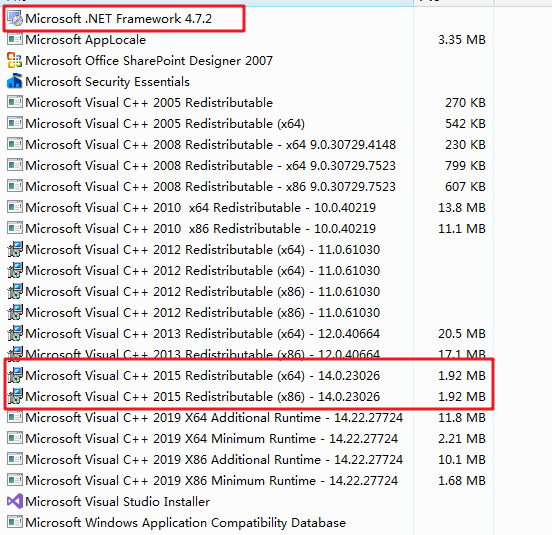

I've tried the steps " https://ephere.com/plugins/autodesk/maya/ornatrix/docs/2/Installation_Problems.html#Sending-us-feedback" here and make sure the vs2015 is installed, my .NET version is 4.7.2, the Install.log file is attached.

and these supplementary pics are my Installed Environment and the performance of its rolled back
Image 1Image 2

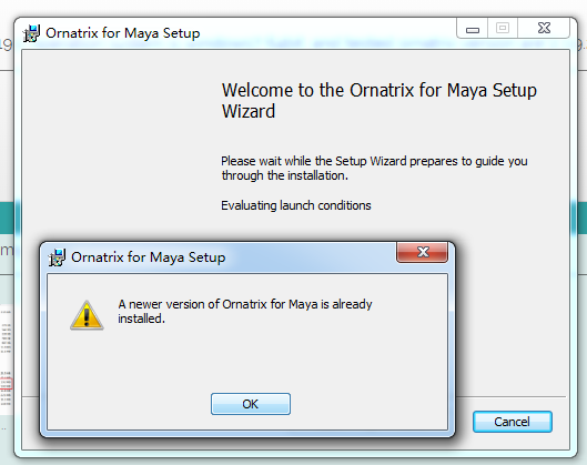

Oh yes that's the problem, as you said I forgot to check the uninstall steps of Ornatrix until I found it can't be installed after my reinstallation of Maya, then I tried to delete all the files remained manually and release the licence from site,as well as cleaned the registry by using registry cleaning tools...
I try to install the previous version I used before uninstalling Maya, and it gives the message as you said:

There is something wrong with your .NET installation, I can't tell what exactly. I tried on a clean Windows 7 machine with just .NET 4.7.2 (similar to what you showed) and the installer worked fine.
I suggest you reinstall .NET, or run some cleaner app to check your system.
If you can't solve the .NET problem, you can install manually from the zip archive. You said that didn't work either, you'll have to provide more details.

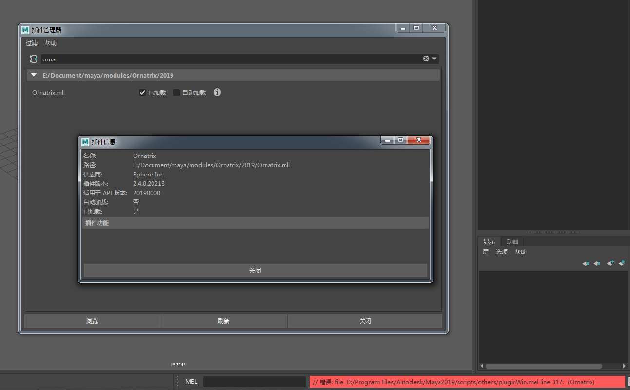

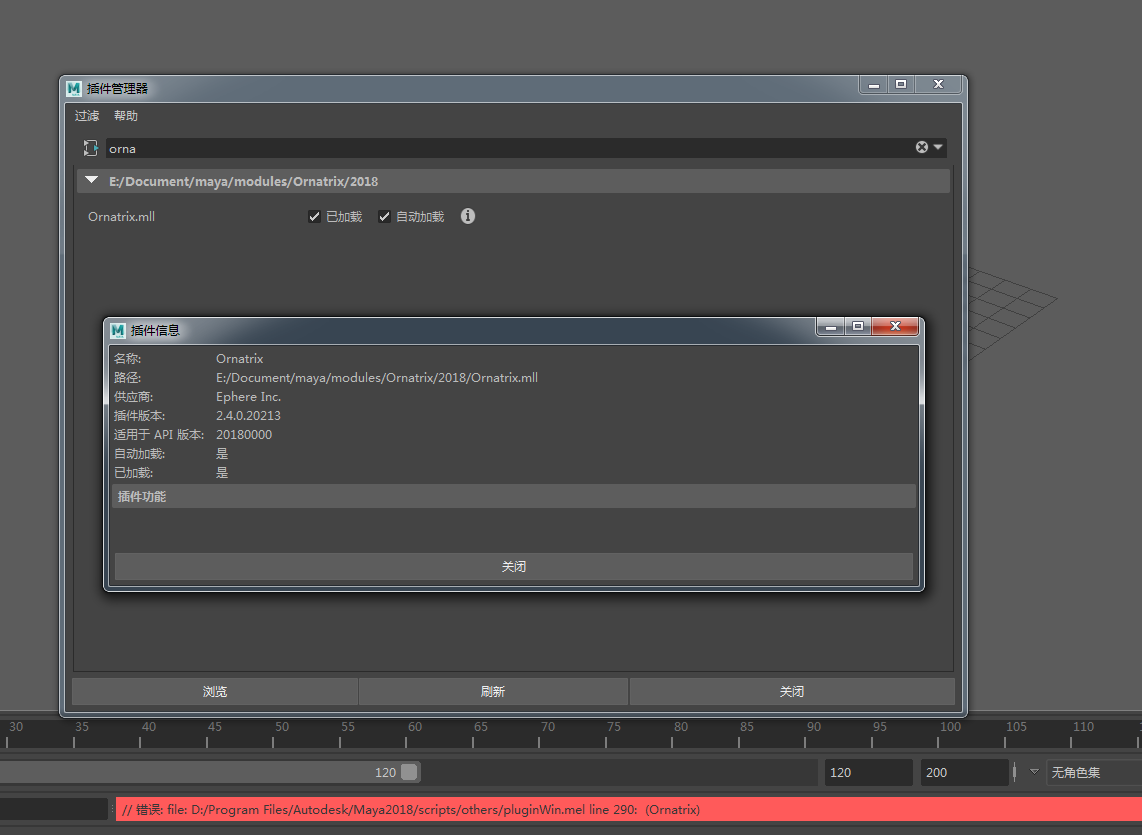

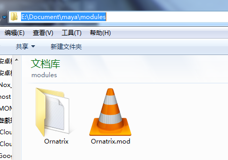

By the way the manually install results are also attached: when I ticked the options, it gives the red error prompt like the screenshot shows...(the Chinese character means "Error")
※Since my documents' path has been customized, I tried all the MAYA_MODULE_PATH as what Readme said, but the results are the same.

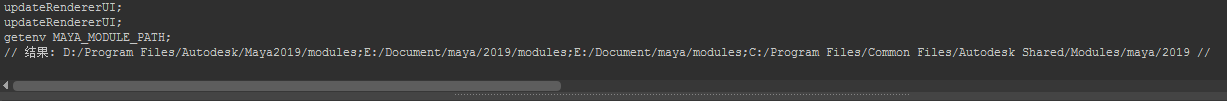

About the manual installation, what does the MEL command "getenv MAYA_MODULE_PATH" print in the Script Editor? Does it include "E:\Document\maya\modules"?
Please post here any details about the loading error from Script Editor, if there are any.

P.S about the manual installation,the script's printed message is like the pic attached below,which including "E:\Document\maya\modules".

OK, so the directory where you placed the files is correct. Next step, please run the MEL command "moduleInfo -lm" and see if "Ornatrix" is on the list.
If it's there, then the .mll won't load for some reason, please paste here the error(s) you get in Script Editor when you try to load the plugin. It's better to copy/paste the error text than make a screenshot.
I just downloaded the archive of the latest stable version, extracted it to my \Documents\maya\modules directory and it loaded successfully in Maya 2018.
