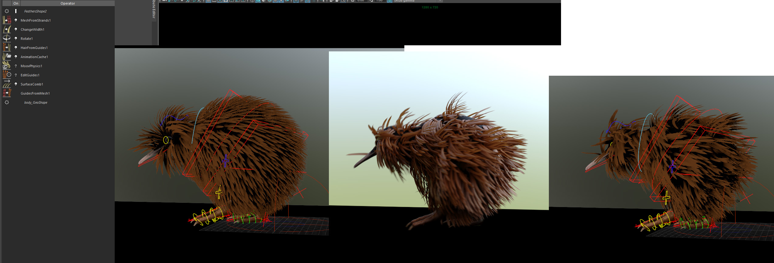

I have this test scene, kept as clean as possible, moov physics node and an animation cache. The cache seems to be working in the scene, reloading a few times, I set off a batch render and you can see the result in the middle image. Then on reloading the scene for a third time, the cache produces the 3rd image.

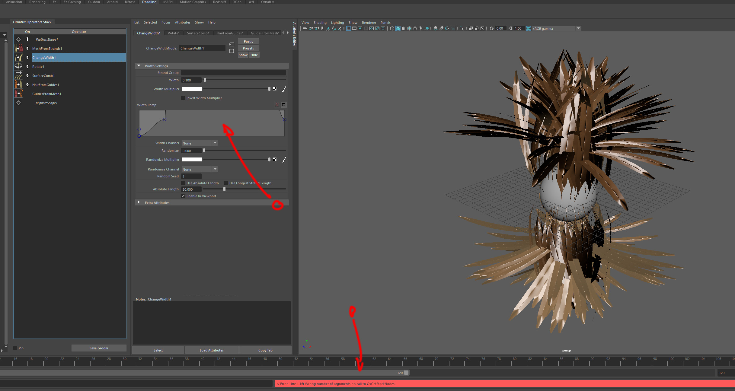

On a fresh scene with a sphere and feathers preset, if I change Guide slection/interpolation/Count. I get these errors:
// Error: Line 1.15: Wrong number of arguments on call to OxIsStackShape. //
// Error: OxGetStackNodes; //
// Error: Line 1.16: Wrong number of arguments on call to OxGetStackNodes. //
I have fixed the MEL error in 21436+ today already.
Regarding the scene with the Dodo, can I try it here with the cache? I will ask Jeordanis to reproduce this from scratch if not.
