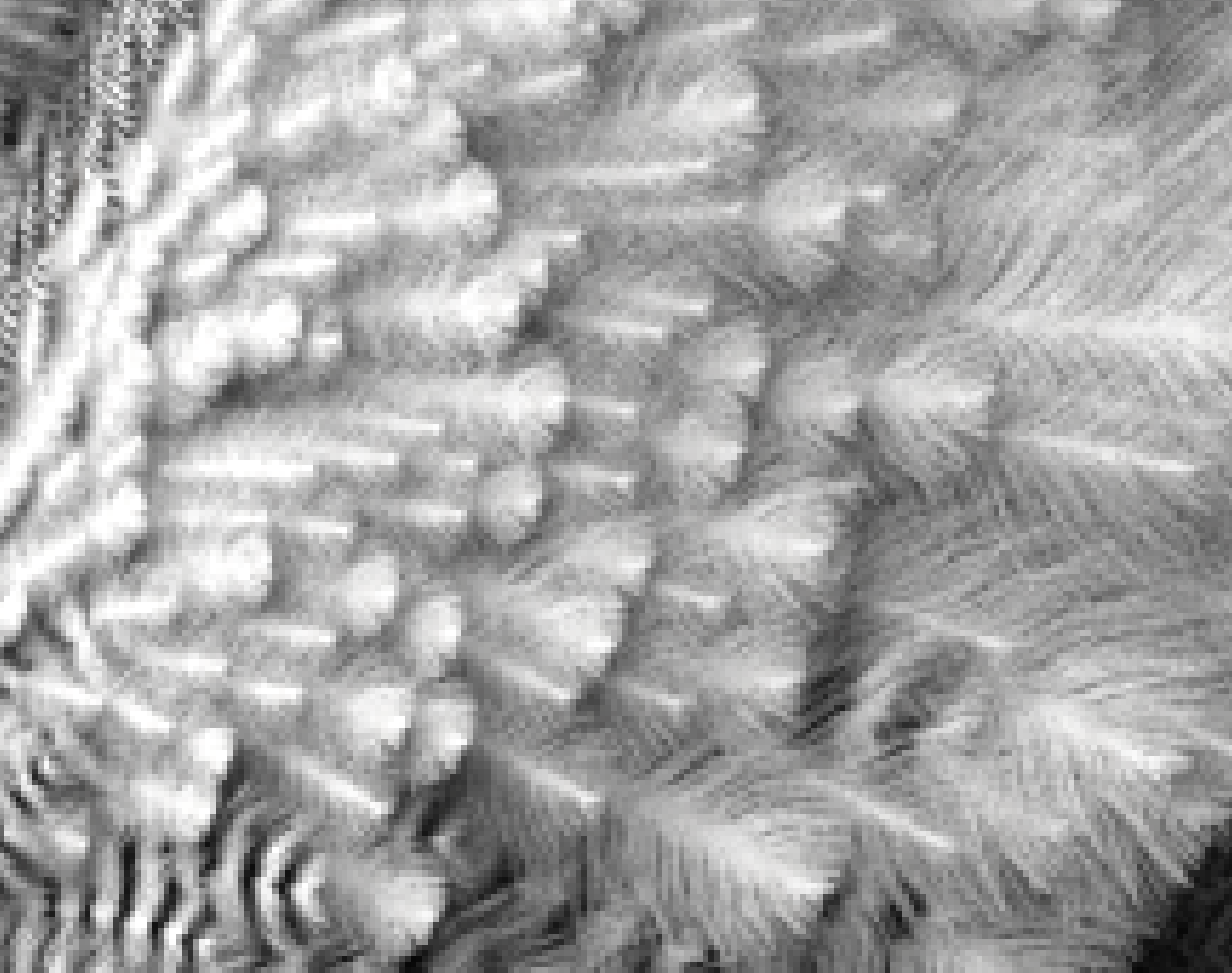

Hello,   I'm trying to figure out if it's possible to connect propagation density to feathers length if I use them as references in scattering, the idea is to make density on smaller feathers less dense, because they start to looks like solid objects in their center, you can see it on attached image. Attached Files: |
| Good question. In GenerateStrandData operator you can apply certain effects to the hair or feathers depending on its length, but we still don't have an operator to reduce/eliminate feather fibers or hairs in a procedural way, which is what you need in this case. For now the only solution that I can think of is using multiple feather objects with different length variations for scattering. Jeordanis Figuereo (Product Designer. EPHERE Inc.) |
| I see. Multiple objects is not easy to manage, I already have many feather systems and split them to even more will make things too complicated, I tried to do opposite here) but thanks anyway, hope this feature will be available in some new build. Do I have to put this idea to suggestions tickets or you already have it in list?) |
