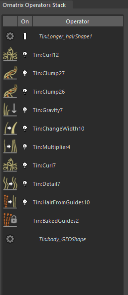

| Can you attach a screenshot of the hair stack? Jeordanis Figuereo (Product Designer. EPHERE Inc.) |
| Attached an image. I didnt originally make this but I have played around with troubleshooting. We thought gravity might be the issue but it turned out to be the clumps. I've tried using just one of the clumps nodes still go same result. Thanks |

| One option would be to collapse the whole hair stack. This will get rid of all the nodes and you will end up with a BakedHair node that contains all the details modeled on the hairs, there you can reduce the viewport hair cound while you work on the hair but keep all the details for the final render. This should solve the flickering problem since there will not be a Clump node anymore in the stack. Please try this while we investigate this issue. Jeordanis Figuereo (Product Designer. EPHERE Inc.) |
