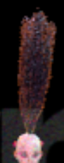

I resolved the problem, now I can see the hair ... but not how I want.
I created the Hair from Nurbs and seems that is not disconnected from the hair ... This problem is only in Batch Render in Render View I don't have problems.
