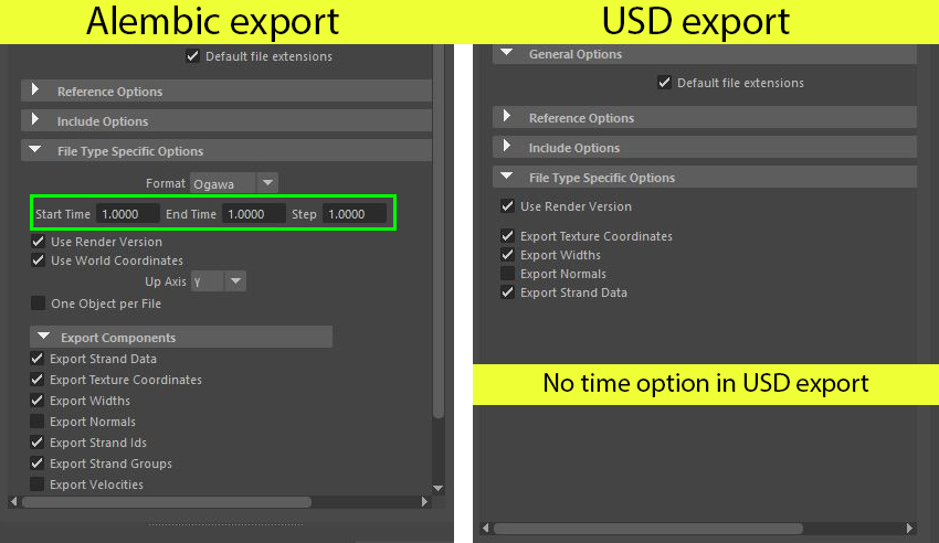

When i export using alembic i get an option for exporting start and end time.
Those time options are missing when trying to export using USD.
Is there a workaround for this?
I have attached an image
Sorry forgot to Upload the screenshot
Thank you for pointing this out. I will make sure that these parameters are added in the next nightly build.
Export to USD curves is still experimental and not a priority. Still, we added support for animation in 3.0.6.24514, the nightly build for Windows is already up.
