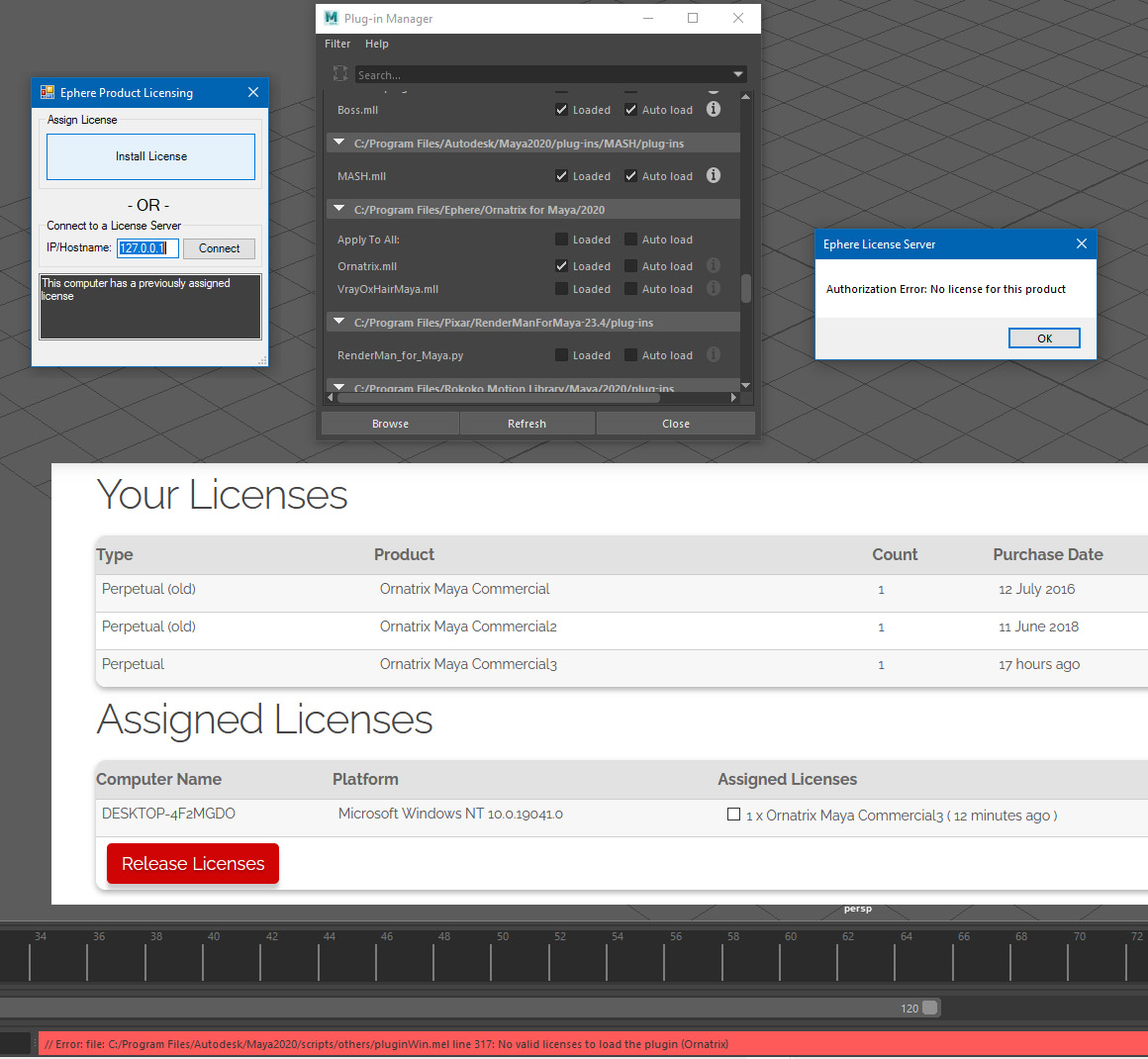

I have tried returning the license a number of times, then when I attempt to load the ornatrix plugin in mayas plugin manager, first it shows 1 unassigned license, I pick the assign license button, it goes through a validation process loading a license server zip in the little ornatrix window, a command window shows briefly, then sort of fails, ending up with a note that a license is already installed but it still wont load the plugin, execution fails???

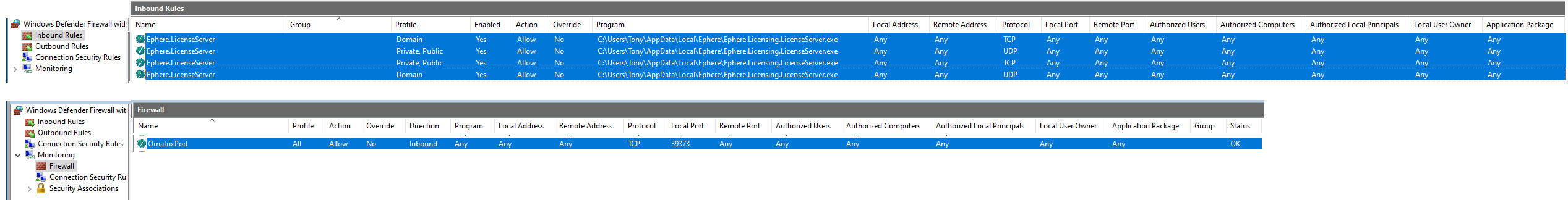

3 check windows firewall, ornatix license apps there seem to be 4, I enable inbound rules, they seem to have access to all ports but I dont know much about the firwall to be fair but I specifically enable port 39373.

5 try maya plugin again, shows 1 unassigned license, craps out when I try to assign license shows like above in the pic (license alreay assigned cant authenticate)

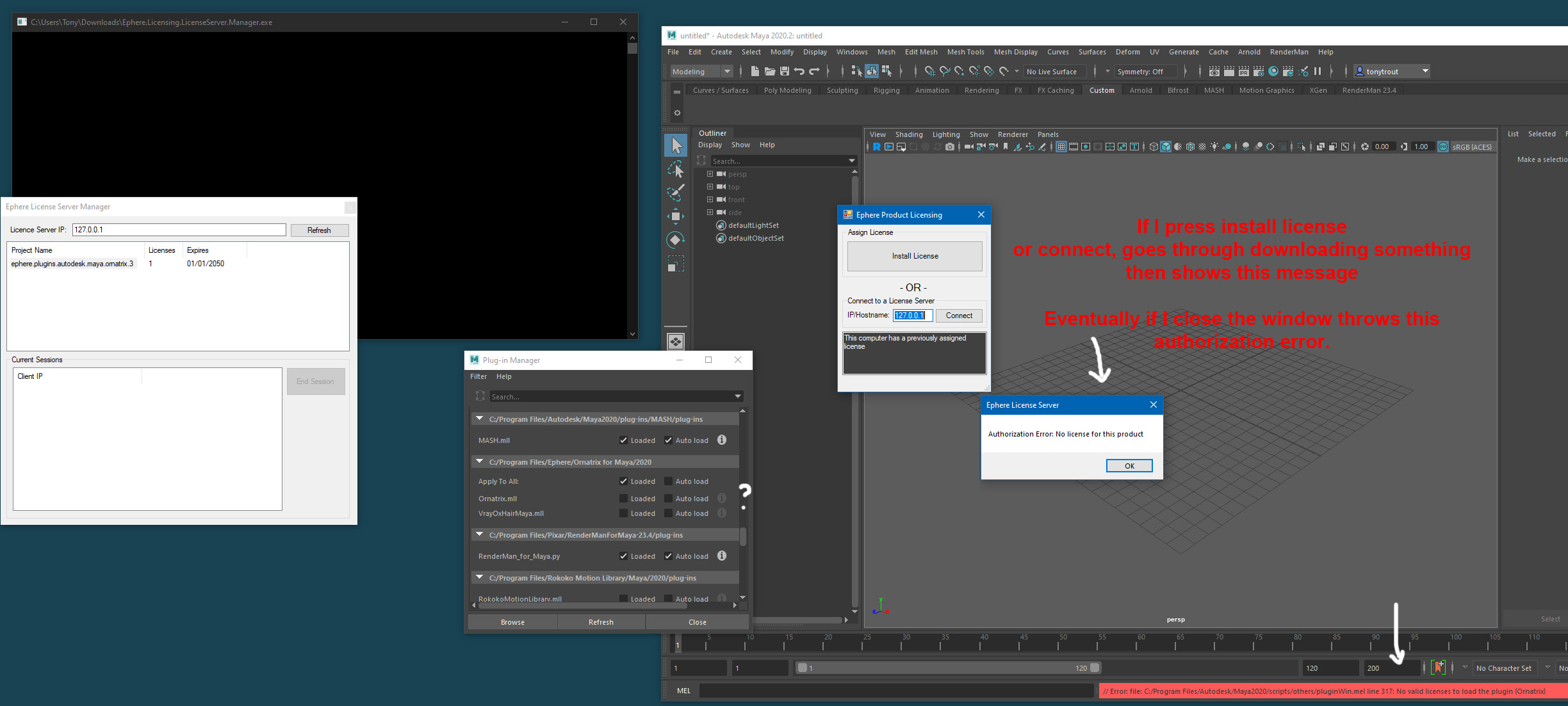

Sorry for the inconvenience. Please try running https://ephere.com/docs/License_Server_Manager.html on the same computer, see what it shows you.
Hi Marsel
This is what I see
