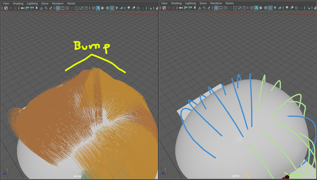

| that did it. thank you. but i still have this problem here. there is a bump indicated in the screenshot, and the hair strands dont really conform to the hair guide i placed on the scalp. need advise on this. Attached Files: 1.JPG
(498840 bytes),
| Maybe you don't have enought guides. Try adding a cople guides around it or move the guide around to see how the interpolation reacts. Jeordanis Figuereo (Product Designer. EPHERE Inc.) |

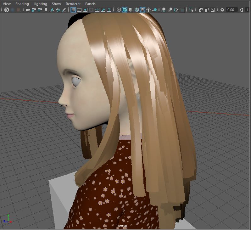

| I re did everything from scratch.
If i dont create too many guides, the interpolation between guides would result in jagged hair strands, but if i create too many hair guides, it would take FOREVER for me to brush each guide.
Please take a look at attached screenshot. The silhouette of the hair is jagged, almost like a stair case, there is no interpolation between the guides.
What setting did i miss for this? thx Attached Files: 1.JPG

| bump. i still need help for this. |
