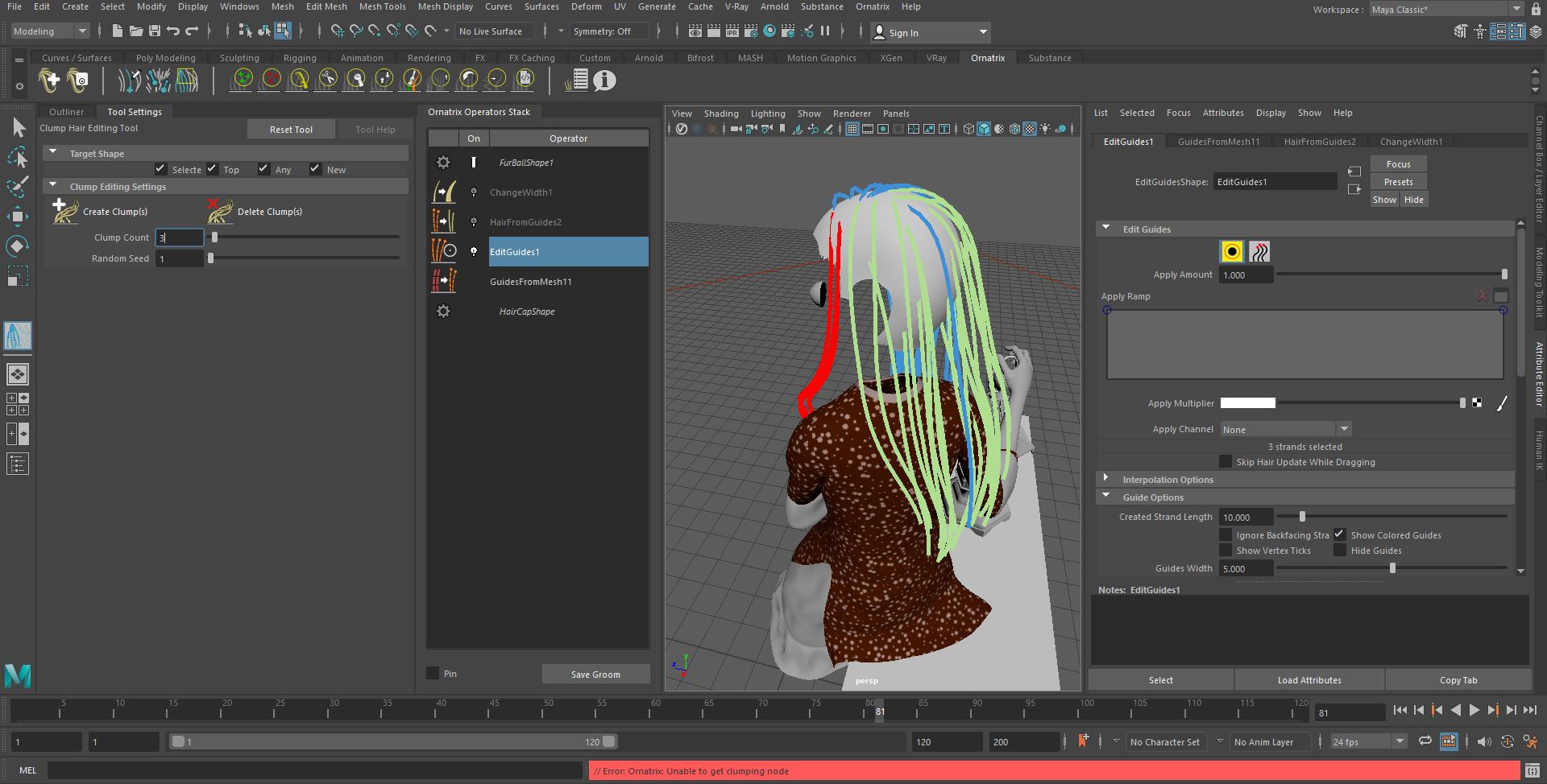

1- Can I select a number of Hair Guides, and Clump them? It crashed Maya 2020.2 first time i tried it.  In the video, he selects the hair when "FurballShape1" is active. I dont like it, because selecting process becomes harder. I prefer clumping but hair guide. The second time i tried it, ornatrix wont let me clump it. See screenshot ( EditGuides1 is active while i push Clump button ).

From the image is not clear what you are trying to do. I don't see any Clump node and Hair from Guides is disabled, hair is needed to generate clumps.

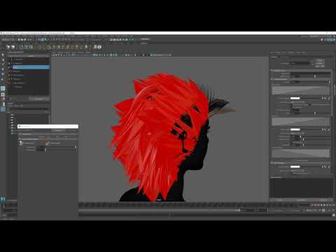

Both procedures of creating clumps are shown here:
m7ye4ScWQYs
If you get any error or warning while trying any of this please paste it here. I hope this is useful.
