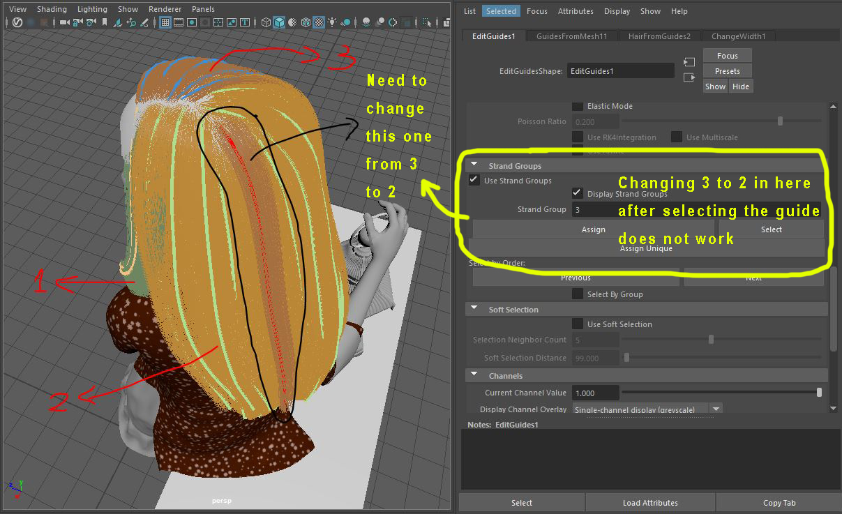

Please take a look at my screenshot. I added a new guide, but by default ornatrix assigned in to Strand Group "3". I want to change it to '2".
I select this particular Guide, go to Strand Groups Menu, and tried to assign "2", but it doesnt work.
Is this a bug? If yes how to do a work around?
You have to click assing after entering the strand group number. See the strand group documentation here.
the ASSIGN button does not work sir.
Please check this video out.
https://www.dropbox.com/s/xnra89xnf4u7dqp/20201015_123017.mp4?dl=0
Did i do something wrong? Advise please.
When you enter the number, if you don't hit the Enter/Return key the value is not actually send to the Attribute Editor template. So the steps are:
  1. Enter the number,
  2. Hit Enter,
  3. Click Assign.
i tried it.Select the guide. Enter number for strand group. Enter. Click Assign.
DIDNT WORK.
Advise please?
it turned out that it didnt work for this particular hair guide ( one hair guide ) only. I tried on the other guides and it worked as you suggested. it may be a bug. do you want me to send you my file in case you guys need to investigate this further?

this is the problem guide. email is sent.
i think the guide that cannot be re-assigned to a new strand group is the guide i planted my self using the plant new guide tool.
please check into that.
i am looking for a way to pre-assign strand group setting before i plant a new strand, because i know this newly planted strand cannot be reassigned into another strand group. but couldnt find an effective way to do this.
Thanks for the scene. We can reproduce the issue and the team it's working on it.
Good idea. Maybe allow auto strand group assignment in the Plant Guide tool. We will look into that in the future.

The strand grouo assignment issue has been solved for the latest nightly build. Please give it a try.
Thank you for your feedback about the UI. We will discuss this internally and do a review in the near future.
i dont see nightly build for windows.
Keep an eye in the download page. It will be online as soon as the build test passes.
