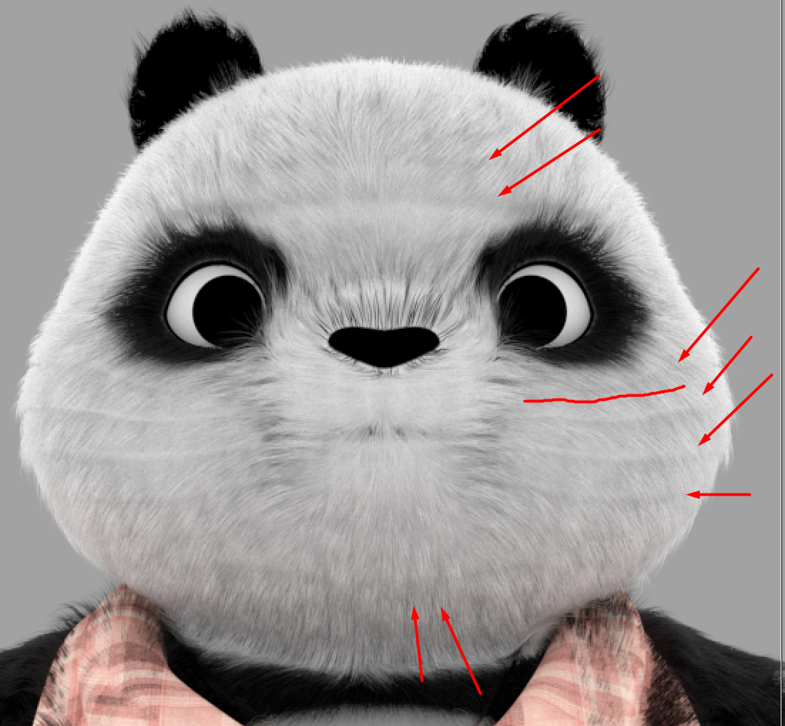

I am doing a panda. It is at the initial stage. I will be changing the nose length, etc.
For some reason. The cheek always gets these lines(image attached). I tested a change different interpolations. for the GuideFromMesh and From HairFromGuides.
But still the same.
Any tip what could be to say clean and smooth? These lines are right on top of the edge flow.
It looks like the mesh is too low poly. If that is the case you’ll have to subdivide the mesh before adding the hair. If you are using version 3 then you can use the Smooth Surface node instead.
Hi Jeordanis,
Now is working. I am using version 3.
I found out that I was using Push Away from Surface with a too high value.
