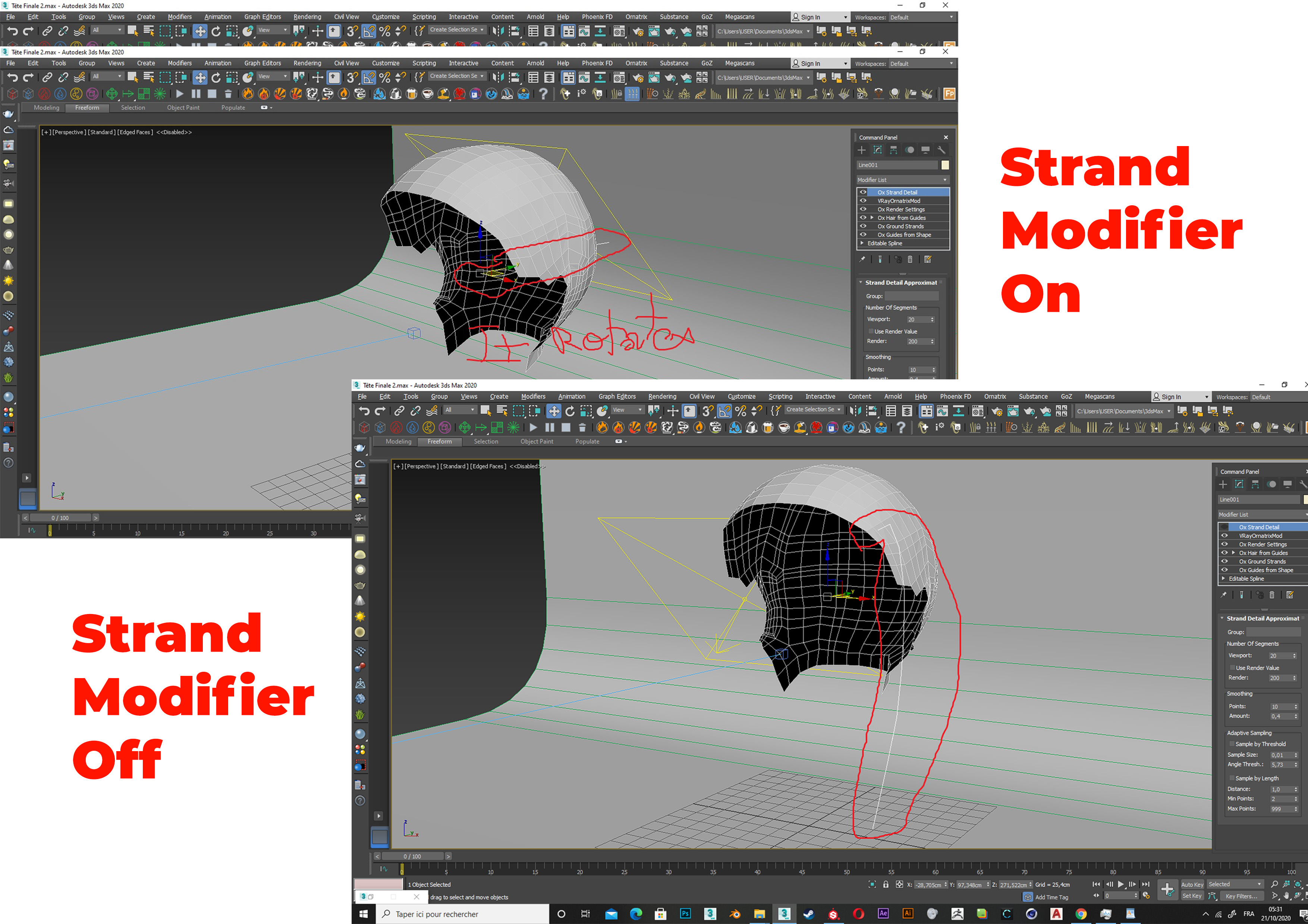

Hi guys, i'm new to Ornatrix , and i'm working with a tutorial.
UnPsbZALnTs
Now , the problem is , when i add the Ox Strand Modfier, it rotates the hair for some reason. See my attachments :
So What can i do to deal with that issue ? Please HELP
Sorry, I missed this post. Are you still experiencing this issue? Can you share this scene for testing and debugging?
Sorry that I missed this post.
Are you still experiencing this issue? Sometimes when increasing the point count of guides generated with Guides from Shape the guides have to be re-grounded. Go to Ground Strands and switch Attach Roots off and on again.
