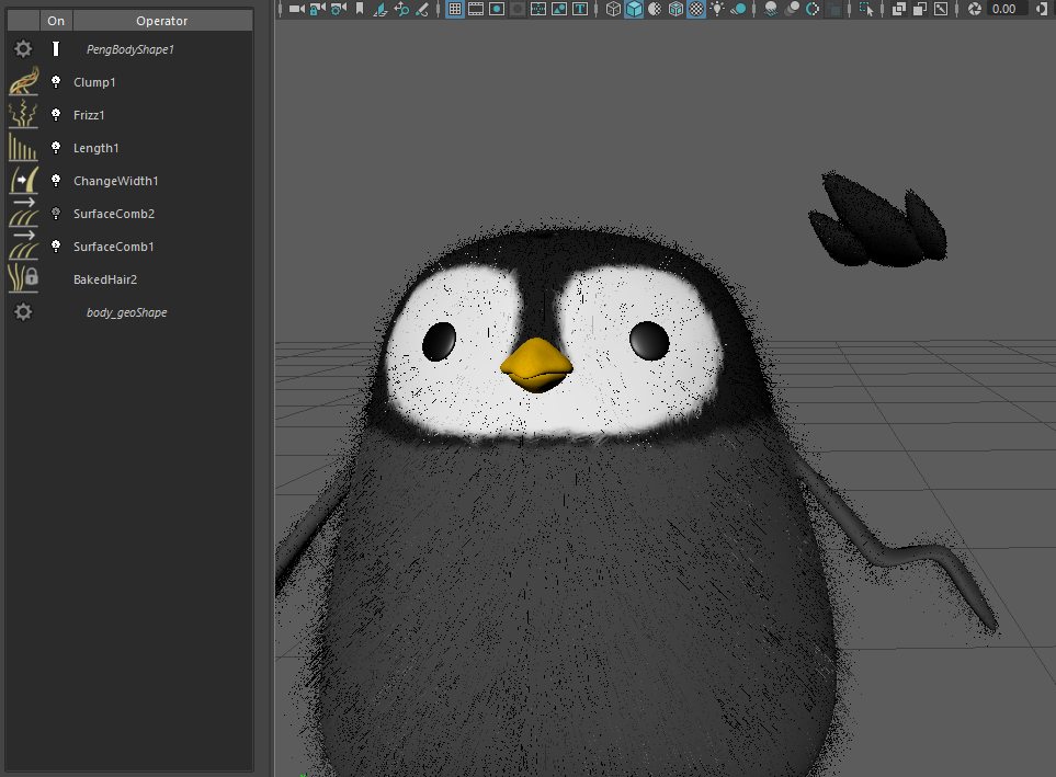

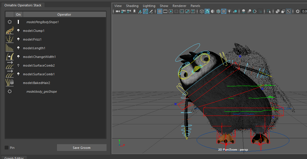

Hello. I am a student. It may be a basic question, but I post the question here because I can't find the answer by searching in the end. I planted fur in my mesh, and when I move or modify this mesh, the hair follows without problem. However, there is a problem when I call this mesh to reference editor in my rigging file. When I move the controller, the fur does not follow the modified form of the mesh. This problem results in the failure of fur to keep up with the animation I gave. The same problem happens in the scene file where I finally bring all the files to the reference editor. I want to try harder to solve this problem myself but my graduation work deadline is close. Please help me. Sorry for my poor English.
In the BakedHair node make sure that the fur is grounded to the mesh that the hair should be following(the character mesh or scalp).
Hello. Thank you for your reply. In the default file with mesh only, the fur seems to be attached to the mesh well. Do you mean to confirm this? I'm so sorry if I didn't understand. I lack knowledge.

This is not a problem of Ornatrix or file referencing. It's actually a problem of Maya's deformations.
The initial advice from Jeordanis was actually right on target:
The hair is not attached to the hair that is actually being animated. The cause for this is Maya's approach to deformation: when you apply a deformation to a node, Maya makes a copy of the original node with a "Deformed" suffix and hides the original.
However, the hair still references the orignial node. So when you start animating the deformed node, hair won't follow it.
For example, in your scene the hair references the "model:hair_geoShape" mesh, while the mesh being animated is "hair_geoShapeDeformed".
As it is Maya's deformation that creates the new "Deformed" nodes, it should be also responsible for rewiring the connections. But obviously it doesn't do that, and I don't know if it can be told to do it.
A simple advice is to avoid this situation by only applying hair to already deformed meshes. Otherwise the hair will have to be retargeted to the new mesh node that was created by the deformation. I can't think of an easy way to do that, only by manually changing all outgoing connections of the original node to the deformed node in Node Editor.
Thank you for your kind explanation. Thanks to your explanation, I can figure out this problem. Unfortunately, I can't fix the Rigging file for the short time left to Deadline. Could you tell me how to fix it manually in the node editor? I want to do anything with the spirit of catching straws.
Well, for each distribution mesh you need to add it to Node Editor, expand its outgoing connections, then add the deformed mesh to the editor and change all connections that start from the "Out Mesh" and "World Matrix" attributes of the original mesh to start from the deformed mesh instead. If you're not experienced with Node Editor I won't be able to describe it here in detail.
