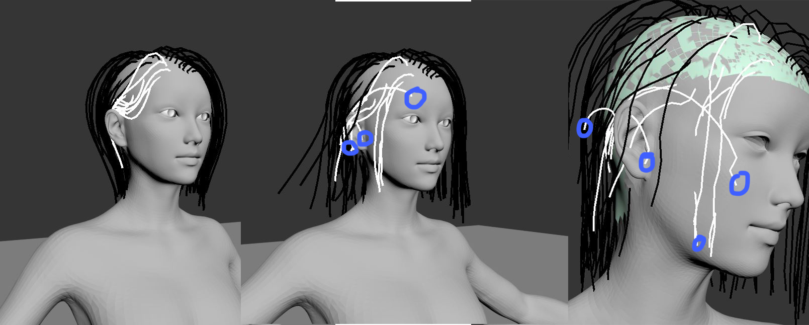

hi I m Having Problem with just Specific Strands.after Applying Physics they are not Attatching to the Scalp.its Attatching but looks like the are attached to the Tip of Hair Instead of Root....i also Made two Selection Groups..white Hairs i  want to take Out from Physics actualy i want to keep the Shape always same even in Physics, i also Added the White hairs Group in Attract to Initial Stage Channel but the are moving a bit Rubbery. i just want to add very little natural  Movement.i am attatching Max2020 File and ScreenShots of Problem.

The reason why the roots are not following the scalp if probably because the roots and tips and reversed. This may be the case if you generated the hair/guides from spline curves. To solve this, just make sure that all your spline curves are pointing in the right direction before you convert them to Ornatrix guides/hairs.

Thanks For your Reply,i create the Spline Guides again,but still there was a Problem,what i did i just Deleted the faces of my Scalp where the Hair Tips Was Attatching to the Scalp .then its Fixed.
is not necessary to make the spline curves again, you just need to invert them to make sure that the tips and roots are pointing in the right direction, then you can generate the Ornatrix guides from them again.
