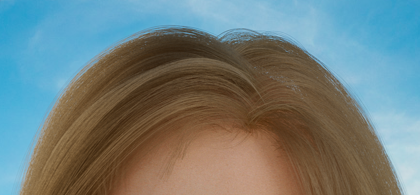

| Yes, all the hair looks sticky. It looks horrible, not like a full hairstyle, but like everything is glued on) I think you get the idea. I don't know how to deal with it. Attached Files:  |
| That is howq Hair from Mesh Strips work. The hair is based on the provided strip shape. The video linked here provides a more expande workflow. Jeordanis Figuereo (Product Designer. EPHERE Inc.) |

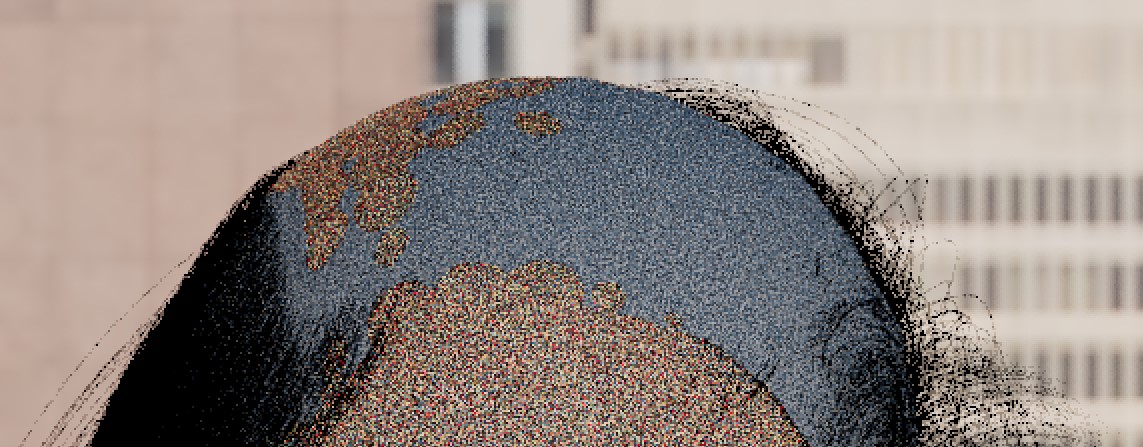

| Hi! I am still experiencing problems. I'm trying to do GroundStrands, but my hair just flies off in different directions. It's like they got electrocuted) |
| As much as I've tried, this is the maximum I can get. For some reason everything happens in a horrible way. Attached Files:  |

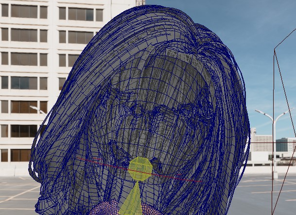

| I don't understand what I'm doing wrong. Repeat exactly as in the video you sent + I deleted the history and froze all the transforms after putting the hair in the right position for me (Mesh) . Next I added HairFromMeshStrips, then GroundStrands, HairFromGuides. The hair flies in different directions and even if I manage to "calm it down" at least a little It doesn't follow the shape of the hair anyway. |
| I got something, and at random, but it is not much different from the result that was. + I can't multiply the hair, I have to use MultiplyStrands node, and it doesn't just multiply the hair, it's the root as you know... that pretty much kills the rest of the shape. |

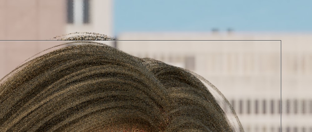

| Please help me figure this out. I've been trying to figure out what I'm doing wrong for quite some time now. And writing on the forum was an extreme decision. I seem to do everything according to the instructions, but I always get the same result. You can see the bad quality of the hair and how stiff it is, as if it was just cut off. In terms of thickness, it's 0.005 and the Ramp is smooth. I also use Multiply to get more hair. Attached Files: |
| P.S. Rendering production quality in 4k. |
