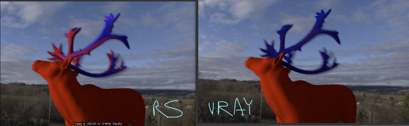

So, we've noticed at our studio that when there's high velocity motion with motion blur turned on in Redshift, that the fur looks like it's not only sliding off the geo, but you can see through to the geo that the fur's attached to. As a test we compared it to VRay, but we are using Redshift for this particular job. Is there a fix for this?
