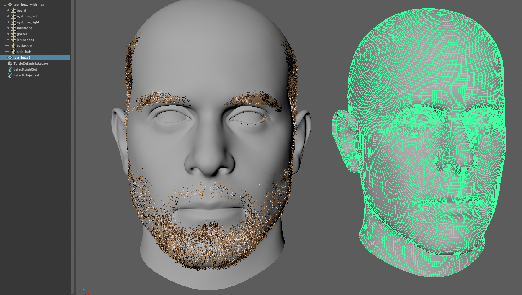

Hello Jordanis,  thank you for replying so quickly.  So here is more information on what I am trying to do.  I have a head that I have assigned different hair grooms for different parts of the face (eyebrows, mustache, beard, eyelashes, etc) and I wanted to take the whole hair stack as you can see in the outliner on the left and bring it into a clean human file and attach each of the hair categories under the new head--while preserving the stack operators underneath so I can continue to randomize hair lengths, curl etc for maximum variation being driven by a json file.  Here is an image to help show you what I need to do.  Would Ground Strands still work in this case without collapsing the stack but be attached to the new mesh?
Yes, the same applies. It is necesary to collapse the stack below Ground Strands to remove the link with the old mesh. Otherwise your groom will be asociated with two characters. If you don't mind that you can keep them both, but I don't recommend it.

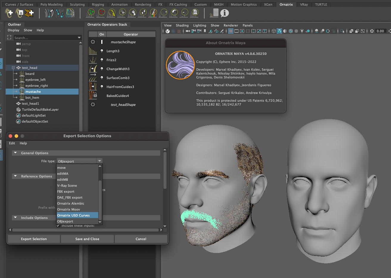

Hello Jeordanis,  Okay so I have set up all the hair groups as shown above in the operator stack.  I am actually using V4.0.6 and I do see that USD export is available.  Am I exporting these as USD curves or something else that makes it ready for import?  I have included an image of where I am at in the process.  Thank you for your help!
This tutorials shows how to save the groom as USD:
4MNEtLmp6Js
Have in mind that V4 is still in beta. Not recommended for production work.
