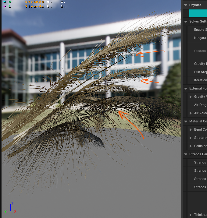

In Unreal my dynamics are applied to both feather shafts and feather barbs, but unfortunately the barbs don't follow the movement of the shafts. Each strand group moves independently, so I have floating feather barbs and the shafts that sink on their own. I have attached an image, hopefully that makes things easier to understand.
Is there a setting somewhere to make the propagated strands (the barbs) remain attached to the shafts?
