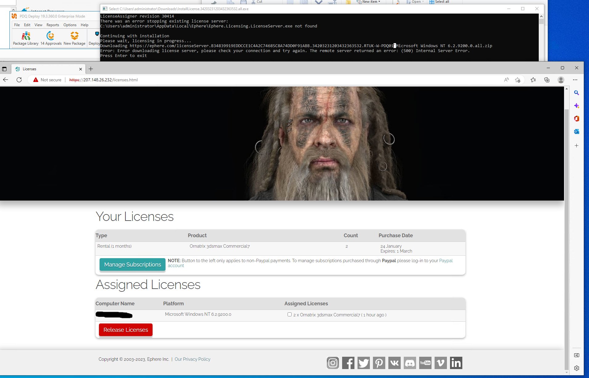

| Hi Tried this but we get 400 responses from when it tries to download the license server. See attached image, this shows that it clealy gets to your site and 'calls home' but then fails to download, however in the URL its trying to get to you can see i highlighted an 'apostraphe' you cant have these in URLs
Attached Files: |
| Try copy-pasting the download link from the console to your browser to download the file manually. Jeordanis Figuereo (Product Designer. EPHERE Inc.) |
| a jeordanis... :)
