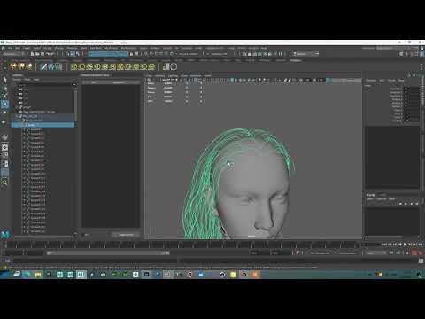

I made a video for all the error and hope this video can be more  cleraly for my question.
Thanks JSdzl1GUTjM
Hi, thank you for the video.
* I'm not sure about the problem with Resolution Gate, Jeordanis may know more about it, but it seems to me it is not related to Ornatrix, because at 8:55 in the video you have a single sphere in the scene and it still disappears when Resolution Gate is disabled.
* The error with Moov happens because you apply it over guides from curves (not guides from mesh), this looks like a bug that we'll try to fix.
* Please e-mail to me the test1 groom file that fails to load, and maybe the 1.obj file too.
