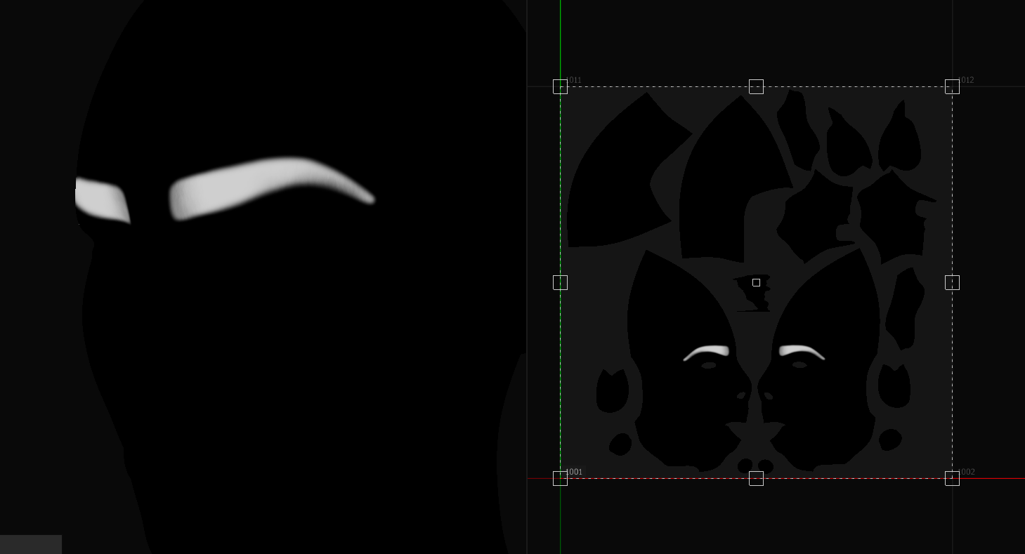

Hello guys! I recently upgrade to Ornatrix 4 (v4.1.5.3...) I noticed that third maps now, however when I plug only one, it doesn't appear to recognize it. It's a map I created directly from subtance, black and white (white for the hair, black for no hair) tif format, 1 UDIM. The uvs in my model are good, however I can't seem to make it work. I'm I missing something? or is it a bug? I'm using Maya 2020.4

Ahh found the problem, apperently it was because of the color managment. I was using ACESS instead of sGRB. (: All good then!
