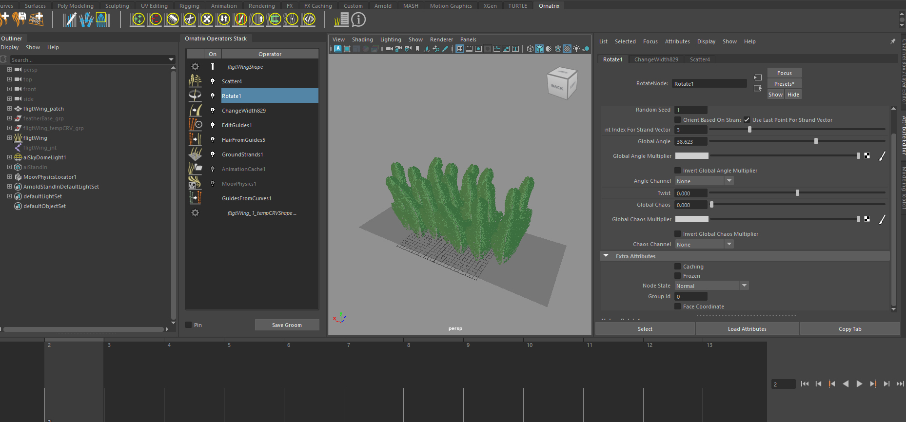

2, < BBB.jpg > Is it possible to rotate the feathers individually?

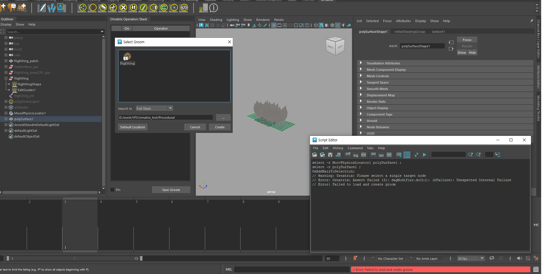

3,< CCC.jpg > 1, Select the feather shape on top of the feather stack 2, In the Ornatrix menu, go to Save Groom In the Ornatrix menu, go to Add Hair. <span>Could not create groom in flagtWing.oxg.</span>

Hi, 1. I cannot reproduce this one. 2. Try the Rotate tool in Edit Guides. 3. I cannot reproduce this. I can save and load the groom file without errors. Try updating Ornatrix to the latest nightly build and Arnold as well. Let me know if #1 and #3 persist. Jeordanis Figuereo (Product Designer. EPHERE Inc.) | |

Hi, 1, <ornatrix_v001> There is an error. I'm attaching a video. movie https://drive.google.com/drive/folders/1wosHFWJ8Tx4QnKt_J2IkFzvzZqWTN9-I?usp=sharing
