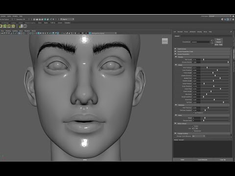

We have been very interested in using the Ornatrix Maya: Procedural Eyebrow Graft Groom after seeing this video from Ephere on youTube: N59T6Tj8QiQ
