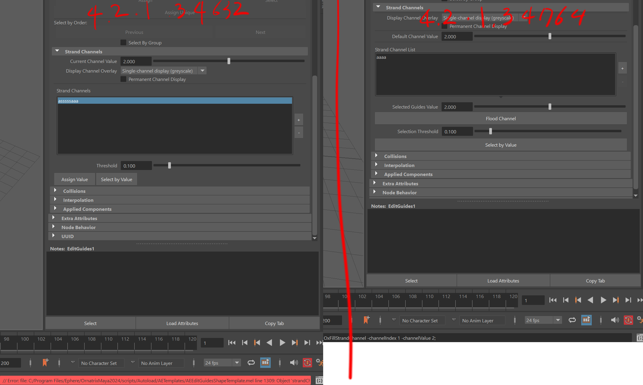

// Error: file: C:/Program Files/Ephere/OrnatrixMaya2024/scripts/Autoload/AETemplates/AEEditGuidesShapeTemplate.mel line 1309: Object 'strandChannels' not found.
<span>Can't you solve this error I inquired about last time???</span>
4.2.1.34764
7/22
<span>I downloaded a new one, but it's the same situation</span>
How are you installing Ornatrix? I cannot reproduce this issue anymore. it was fixed recently.
Can you try uninstalling and reinstalling the plugin?
Maybe the installer did not update the script files for you. Try removing the scripts folder found in "C:/Program Files/Ephere/OrnatrixMaya2024" and reinstall the plugin.
If the problem persist, find the file mentioned in the error and attach it here.
Oh I'm sorry I downloaded the latest version and the problem has been solved. But the latest stabilized version still has the problem. But I'm really happy that it's been solved. Thank you
Correct. Bug fixes come to the nightly builds first. Glad it's working for you now.
