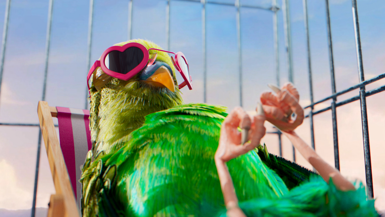

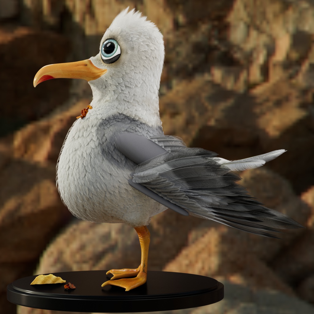

thx for the reply Ivan. Im sorry I didn't reply earlier but I've been busy accross production. I am getting strange behavior when trying to render shots through deadline using Maya 2023 & Redshift. I have two nodes that render fine and another two that refuse to render hair on anything but the first frame they are assigned. After that, they render all the geo but no ornatrix. It's frustrating to be so close. I'm using the latest V4 stable version. Im rendering to deadline via Maya Batch and I'm not baking any cache data as there are no sims. Attached is an example of the characters - so fur and feathers. Any ideas what might causing the render to fail ? I'm not using a local licence server and turned off all firewalls to problem solve

We've had reports about problems with Deadline in the past, we can't do much about that, it's usually related to Deadline settings or usage.
We can only suggest general troubleshooting, like first try to render the scene locally on the failing node, see if anything's missing (some plugin or some assets, maybe a referenced scene), check for error messages, etc. Once it renders locally in Maya, try to render with Maya Batch but without Deadline. If it works without Deadline, figure out what's missing in Deadline to work properly.
Hi Ivan. Yes i can confirm the scene runs locally perfectly on the failing node. I'll review the rest of your suggestions. there is zero chance it is a licensing issue ? I only own one licence but you have an excellent render only policy. ( yeti is restricted to 3 render nodes per licence ) also would it perhaps help if i installed the render licence server locally ?
If you run the plugin in Maya Batch only, it doesn't even try to acquire a license.
