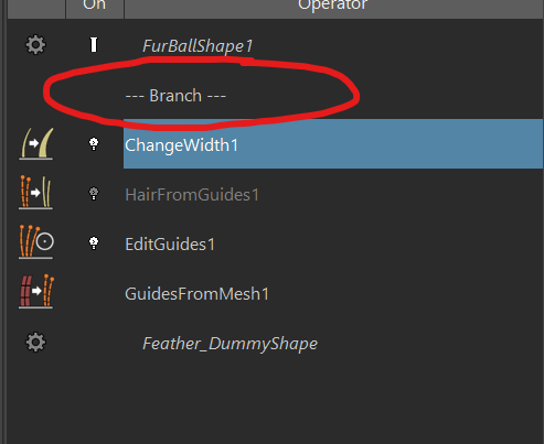

The mesh from stands changes like that in the middle of work, how do I fix it?
4.2.4.35022 .ver maya
Can you provide the scene?
Looks like some operator connections are messed up. What were you doing before this happened?
I was simply planting a few strands of card mesh
And the scene in the picture was tested separately in the plan

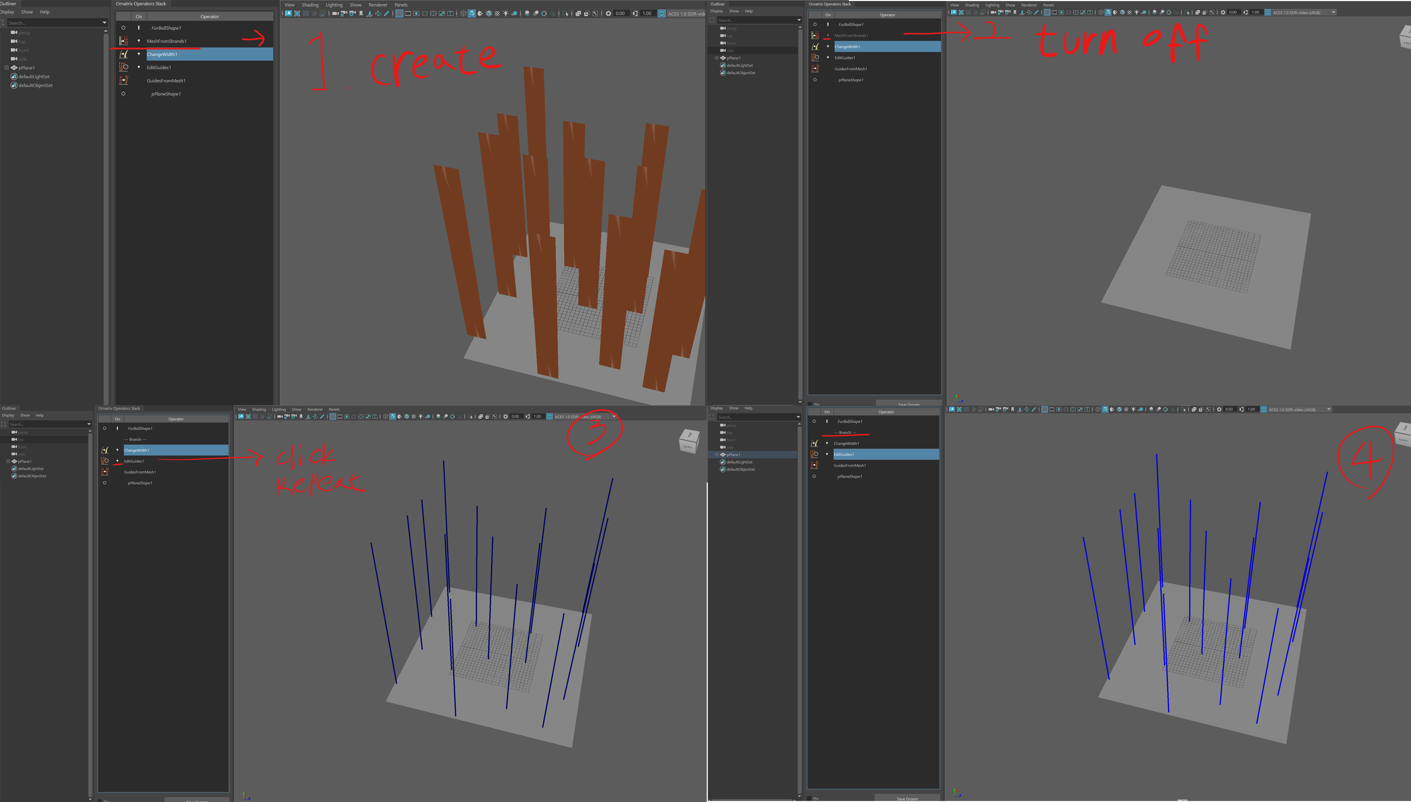

Hiding mesh from stands and turning off and on the sub-stacks, that's what happens
I can't reproduce it, maybe I don't quite understand what you're doing. I'll need the exact steps.
This will happen unconditionally if you execute the 4 steps. Maya version is 2025.3    Before formatting, I used version 2024, but the same phenomenon occurred with version 2024.

I have encountered a similar situation. The old version didn't have this problem. The new version does indeed have branching issues.
Thank you, I reproduced it now.
Fixed in revision 35297, a new build will be uploaded soon.
