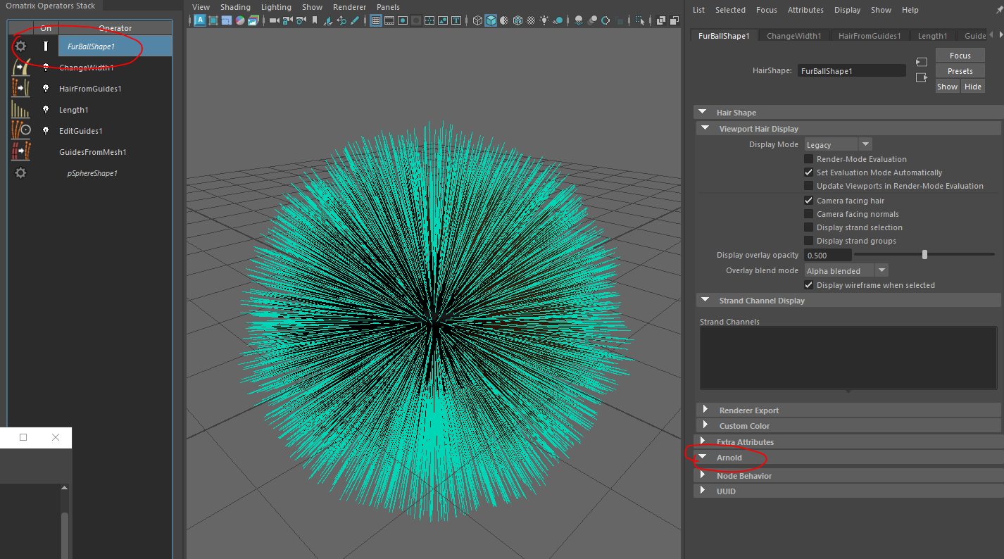

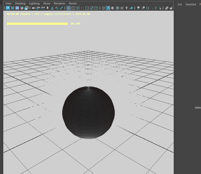

Then, when I try to upgrade my Ornatrix plugin to the latest version (4.2.5), I could no longer view the aiStandardHair shader from the arnold render view. (as in the attached screnshot, the strand hair around the ball is gone when I switch the viewport to arnold)

Then after I applied the change, I can see a new aiStandardHair shader is added in Hypershape window
but when I click on the strand hair shape node (as in the screenshot), the Arnold attribute is empty
Does that mean the material is created but not assigned to the strand hair? how could I fix that?

Ah, turns out I need to use Mtoa 5.4
https://ephere.com/plugins/autodesk/maya/ornatrix/docs/4/Arnold_Compatibility.html
