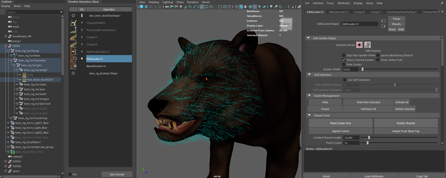

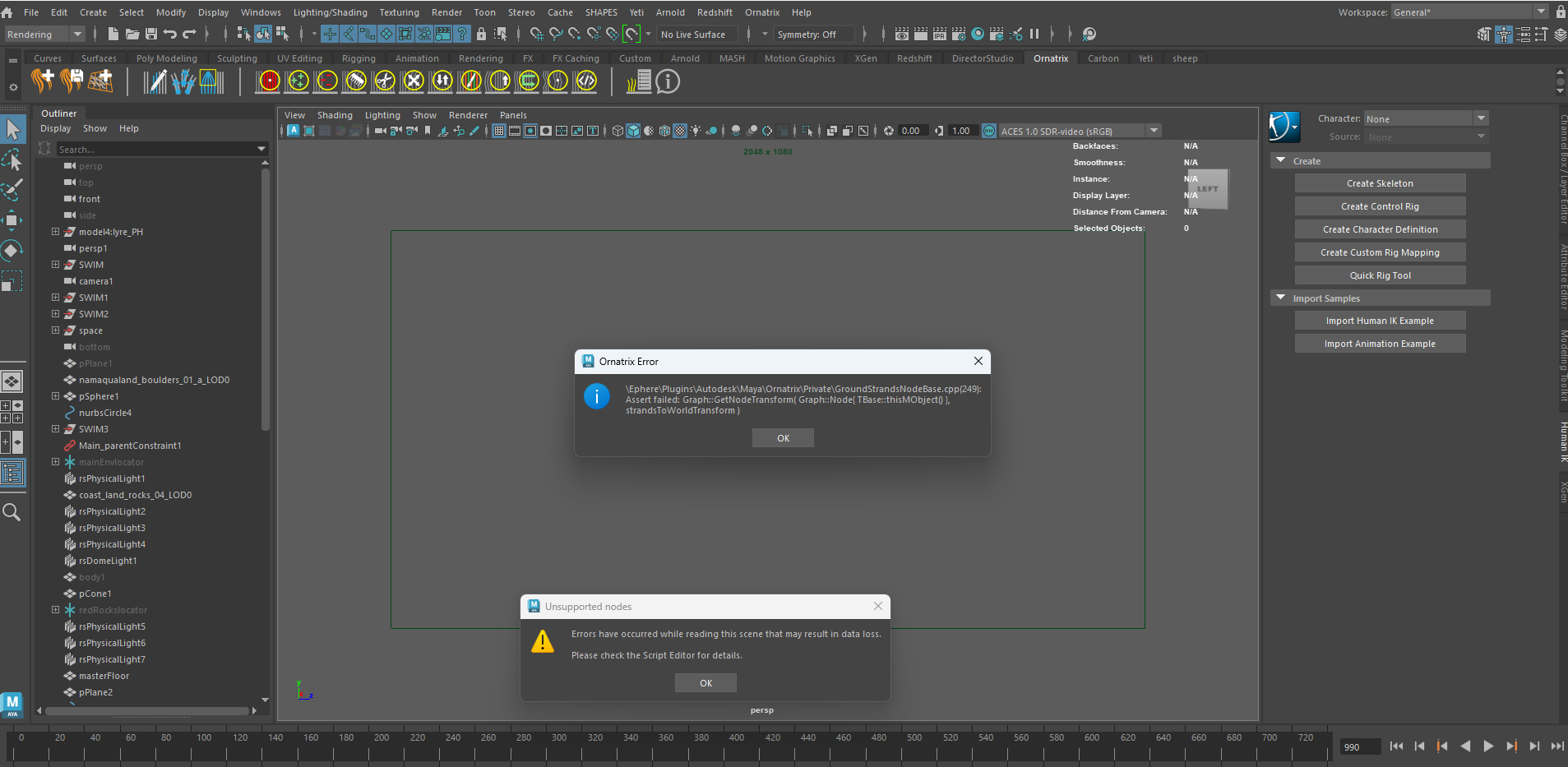

having two issue with orntrix
the first is the error attached when loadind a scene with ornatrix used,

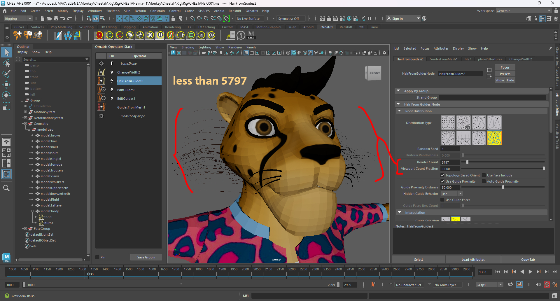

the second issue is "HairFromGuide" is generating a viewer amount Hair from EditGuides (like is avoiding some guides).
This is our first major project we are on with Ornatirx, switching away from Xgen. Please Help
Image 1Image 2Image 3

The Viewport count fraction is 1, but the render counter hair count is far higher than what is viewed in the viewport also when rendered. in the file attached
render count= 5797
viewport count fraction=1
what is observed in view and when rendered is less than 100 hair strands

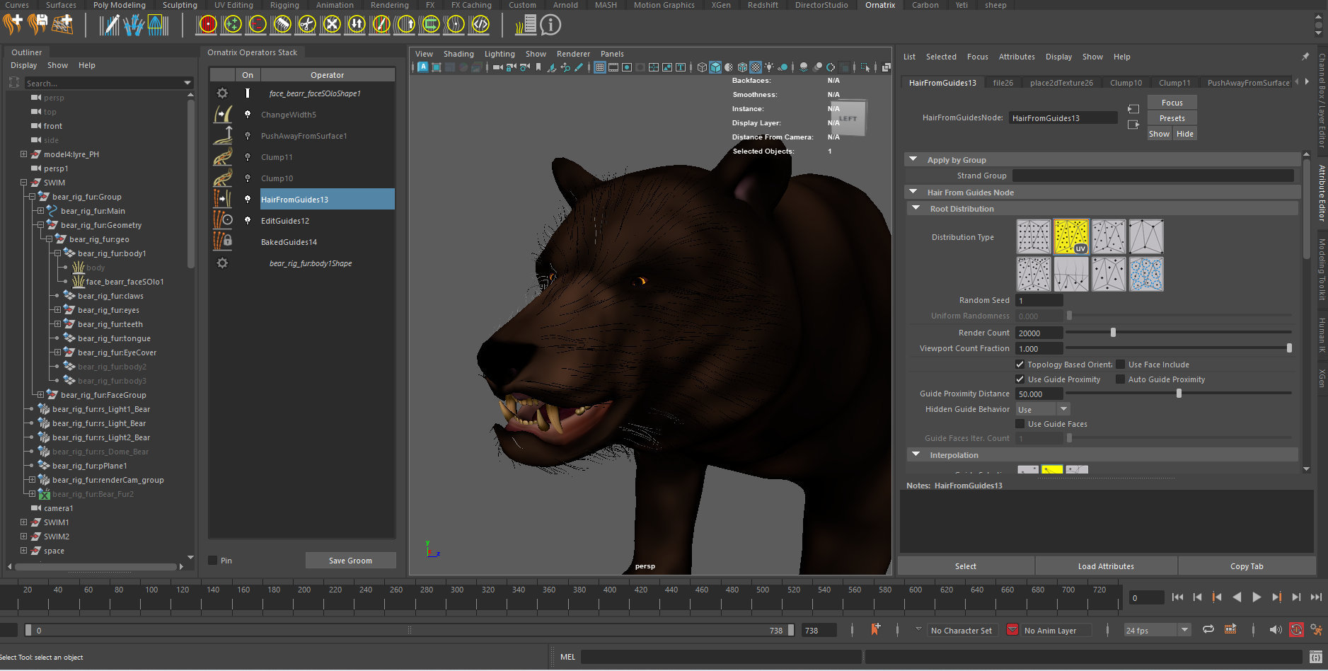

Looking at the screenshot of the operator stack it looks like the groom graph may be broken somewhere but I need the scene to double check.

By looking at your screenshot and your details above, makes me think that maybe you are either using a multiplier map in Hair from Guides to define where the hair roots should be distributed,
or you are generating the hair directly on a polygon selection. If so, this is not a bug. keep in mind that the Render Count is more like a multiplier value, it is not the actual root count that you will get, specially if you are filtering out strands using maps or polygon selection. So, feel free to keep increasing the Render Count value unil you are happy with how it looks.
You can check the exact root count by adding an Edit Guides node above Hair From Guides, look at the "Strands" value under the "Selection Mode" section in the Attribute Editor(With Edit Guides selected).
If I'm wrong and you are not filtering out the strands as I mentioned above, please provide the scene ready to reproduce the issue. Make sure to prepare the scene as described here.
True. i maped a texture into the distribution map of the HairFromGuide.
How else can i control where i want hair growth area with the root count matching ituitively?
Since Render Count is a multiplier it won't be an accurate number. perhaps we should rename this parameter to make that fact clear. To check the exact root amount so it as I explained above: Just add an Edit Guides node at the top and check the "Strands" field below the selection mode section. That number is accurate.
