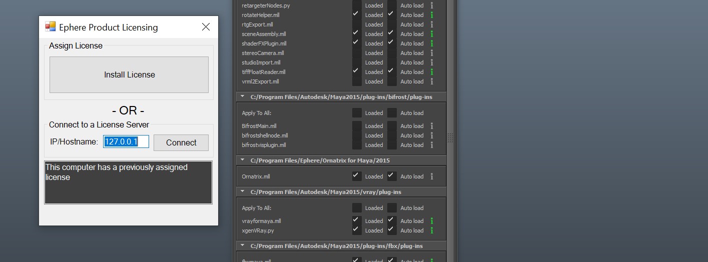

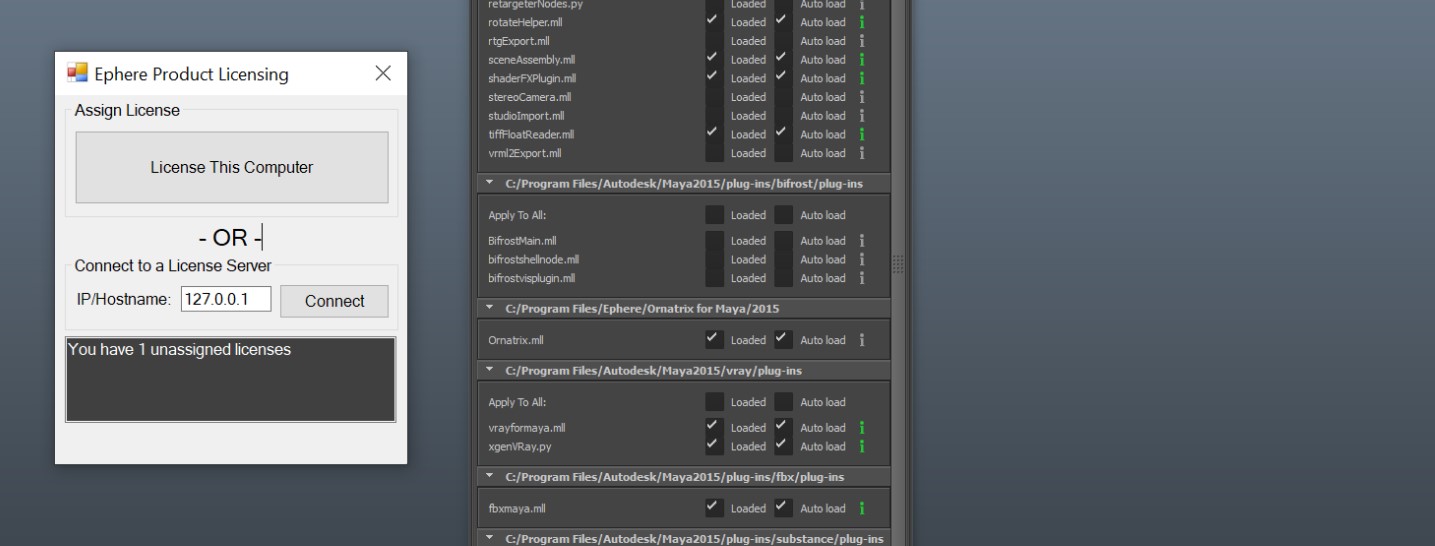

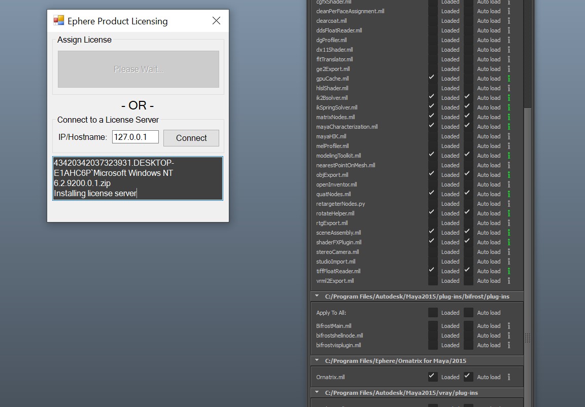

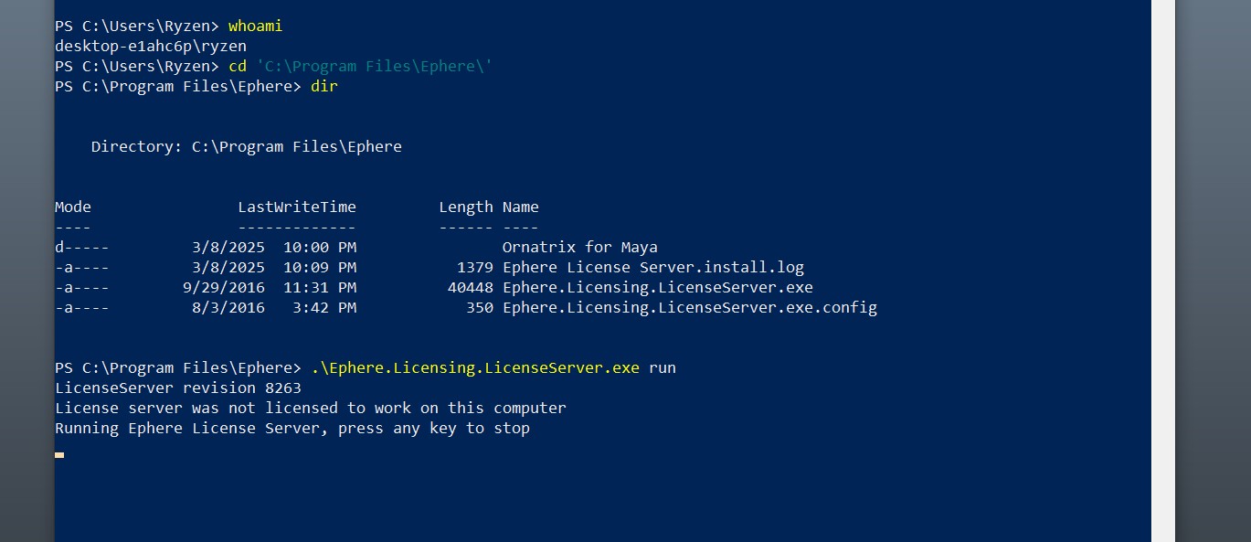

when I manually start the license server in the power shell, the last image is what I get.  Says its running, but not licensed for this computer :/
Image 1Image 2Image 3Image 4

Which error are you getting with licensing? There may have been changes in the current license server which make it incompatible with V1. Does the license server install? What do you see in the command window which pops up when installing it?
Just saw the screenshots. You get the message that license server isn't compatible with your HID. Please try re-installing it from the website.

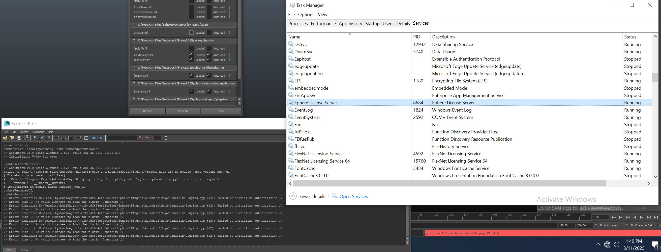

  The uninstall worked, and then when reinstalling I followed the offline computer instructions.  I can now see the Ephere License Server service running in the Task Manager.  When clicking to activate the plugin in Maya, I get a new error, different from before.  This is a new "no valid licenses error," and I do not have this directory D:\TeamCity on my machine, so I'm not sure what else to do.
What do you see if you run the license server manager?

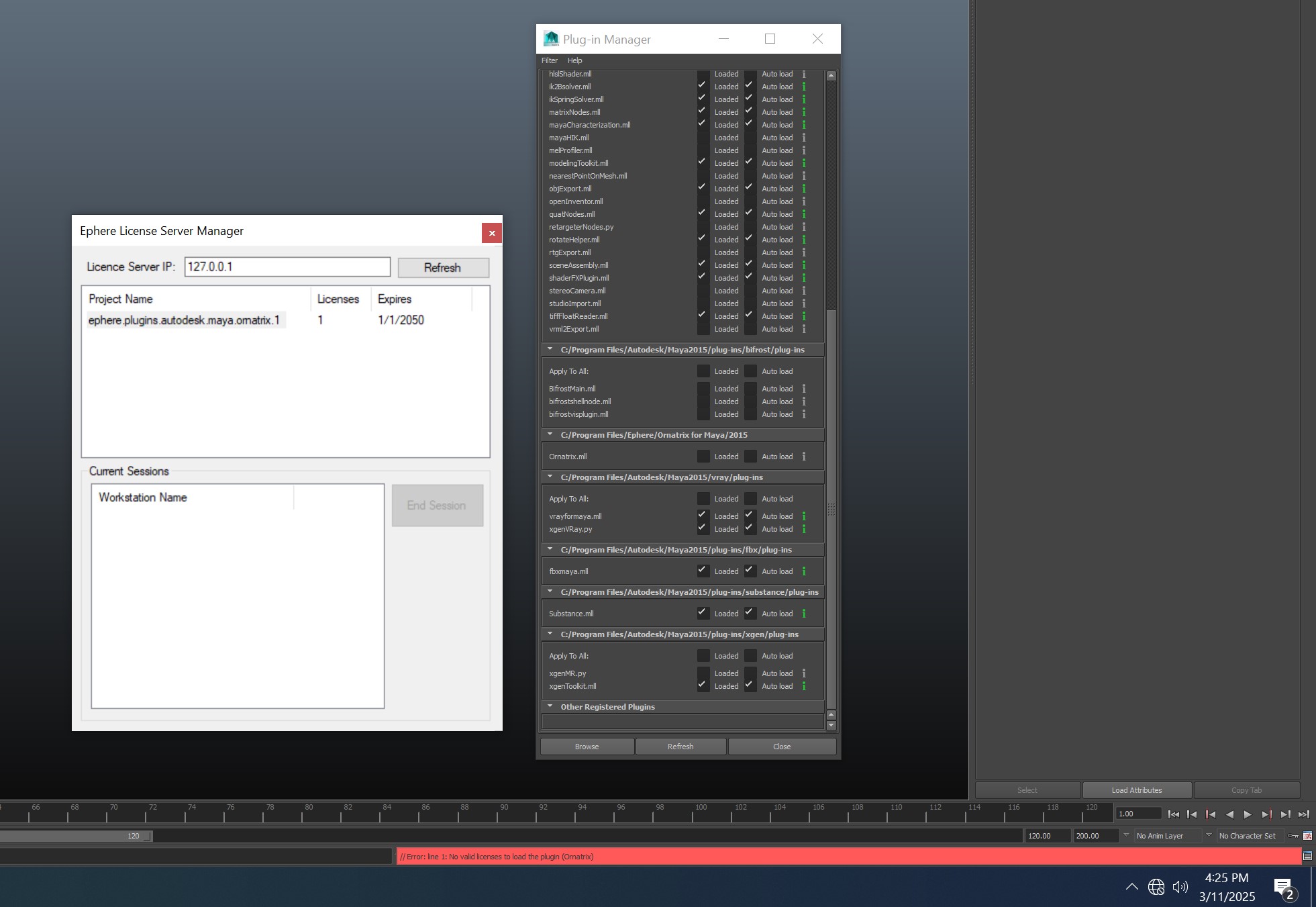

This is what I see with the manager.  I can't get anything to appear under the current workstation name.
On the machine that died, I used to run the ephere license server from the command line.  If the ephere license server is now running in the services, I'm assuming I don't need to do that.
Your screenshot shows that the license server with the correct license is running. However, as I suspected, it probably doesn't work because there were many changes (including to the license server) since V1. We can't really (custom) build the old license server anymore because the code tree has evolved too much at this point. Is there a way you can try switching to V4 (or V5 beta)? Maybe we can try sorting out issues with loading your older grooms?
