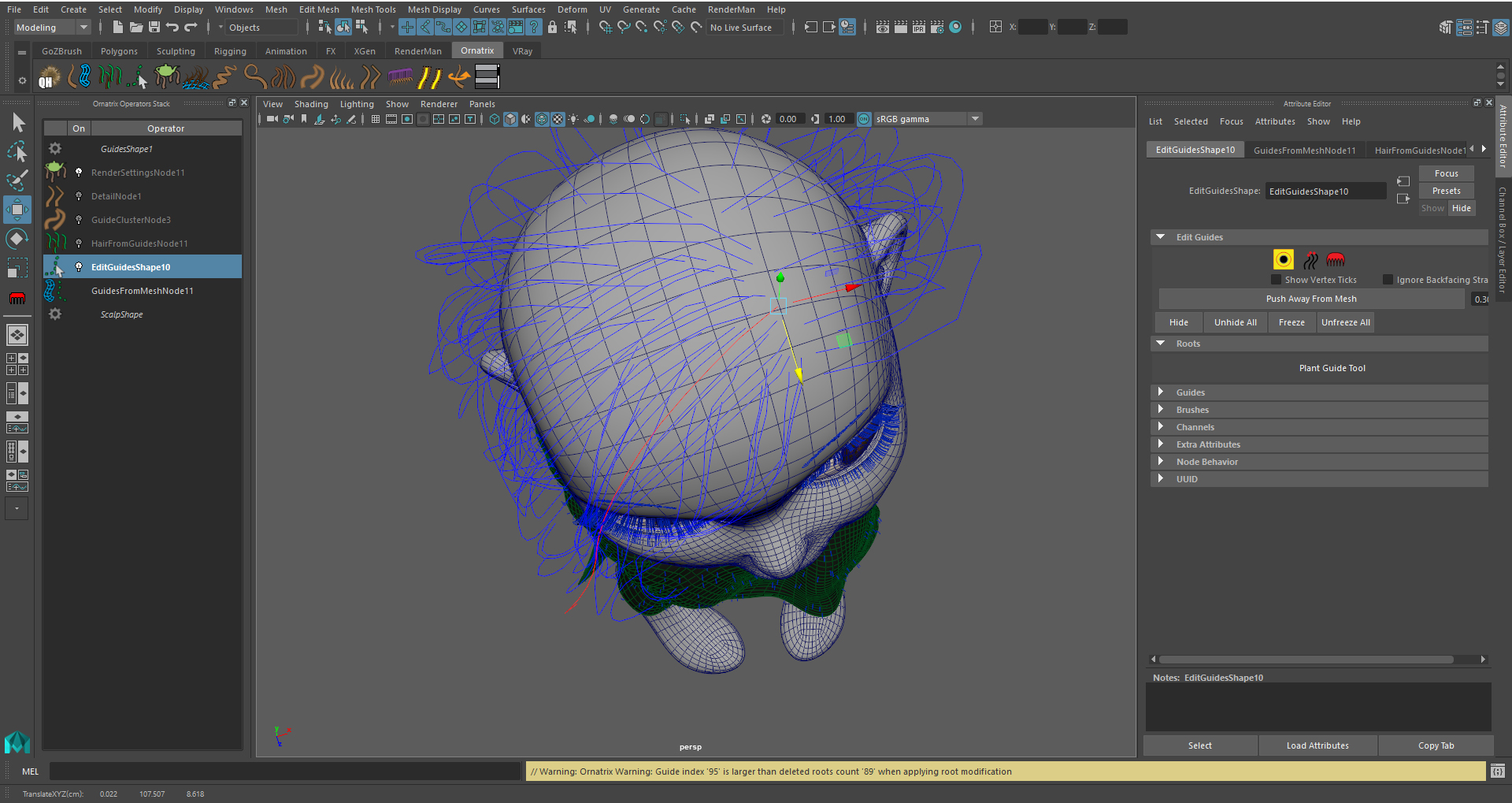

Good morning! In the latest night, I had a problem with move roots, appeared for me the follow message: "Warning: Ornatrix Warning: Guide index '95' is larger than deleted roots count '89' when applying root modification". Appeared this after I add many guides (by plant guides) and now I can't move the some roots. I would like if this is a bug or only warning of limitation... Thank you! Attached Files: |
| Sounds like a bug. Can you please send me the scene if it happens after open? Marsel Khadiyev (Software Developer, EPHERE Inc.) |
