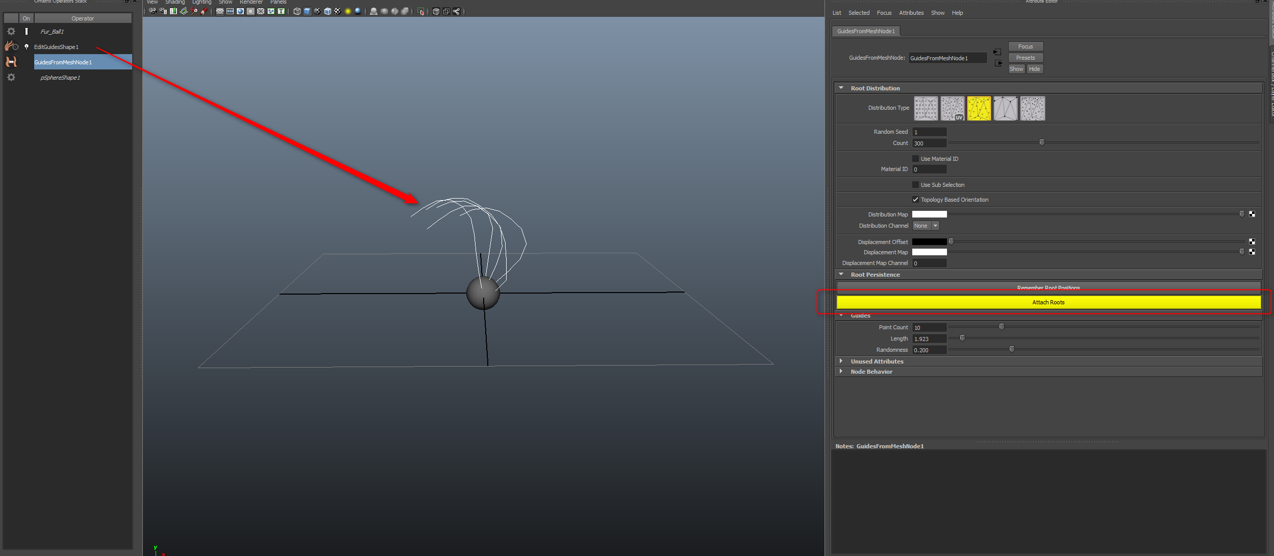

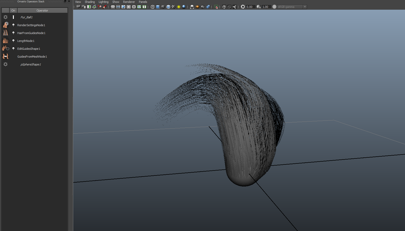

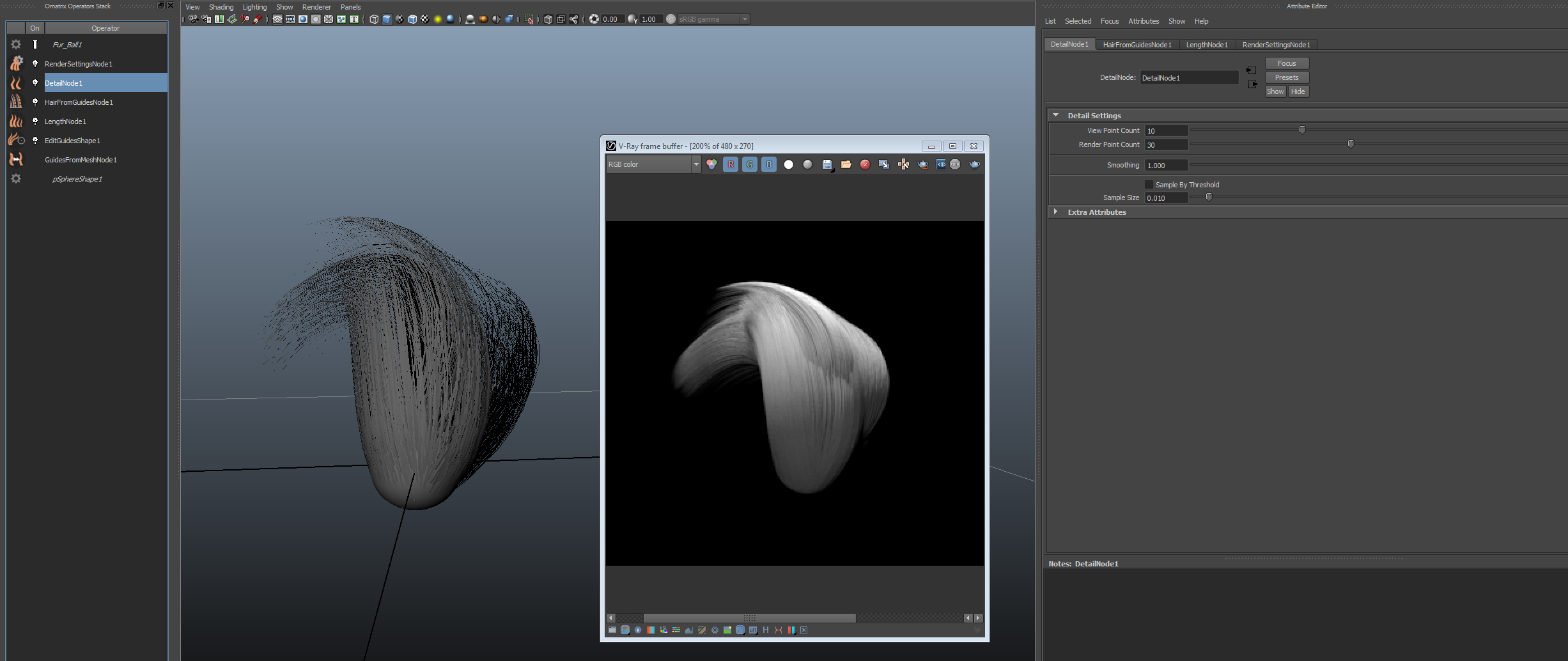

it looks like if you hit the detatch roots button in the GuidesFromMeshNode you will clear out all of the guides and then you can create new guides. Then add your hair from guides and because you don't have anything from GuidesFromMesh to control the detail of your strands... add a detail mesh and it renders smoothly. (example in Vray)
updated pictures
also adjust your sampling on the detail node.
