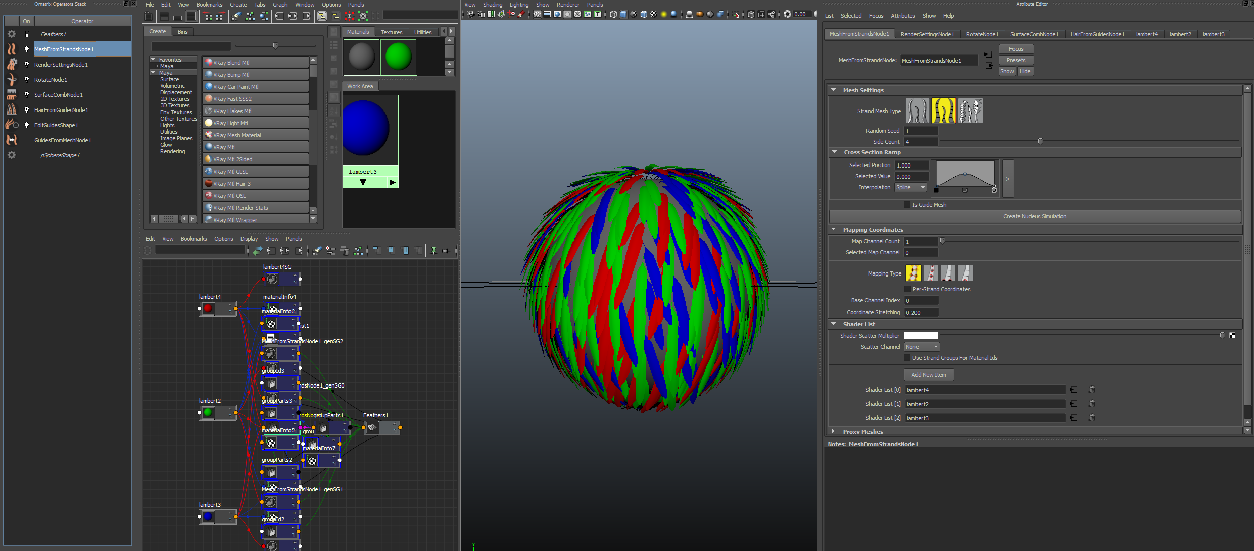

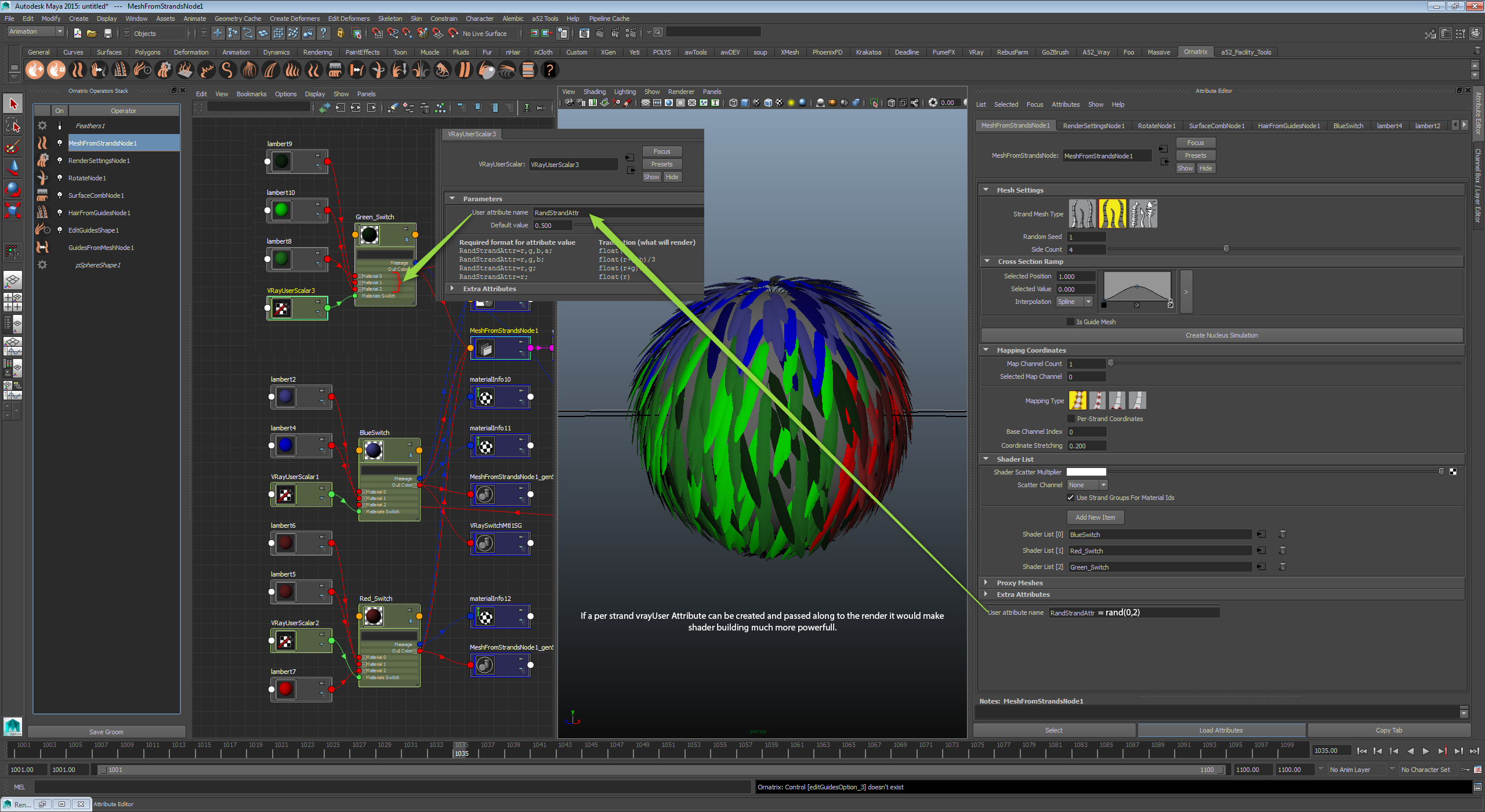

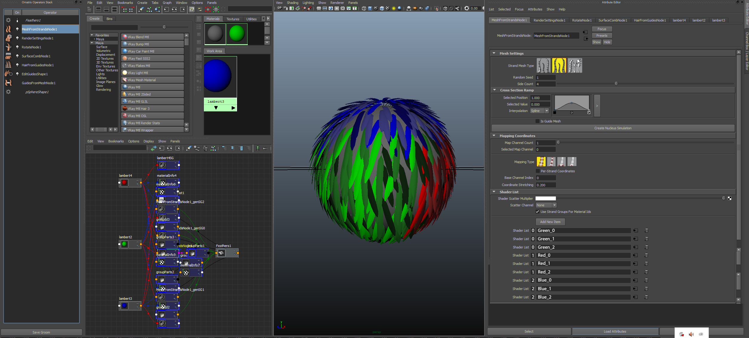

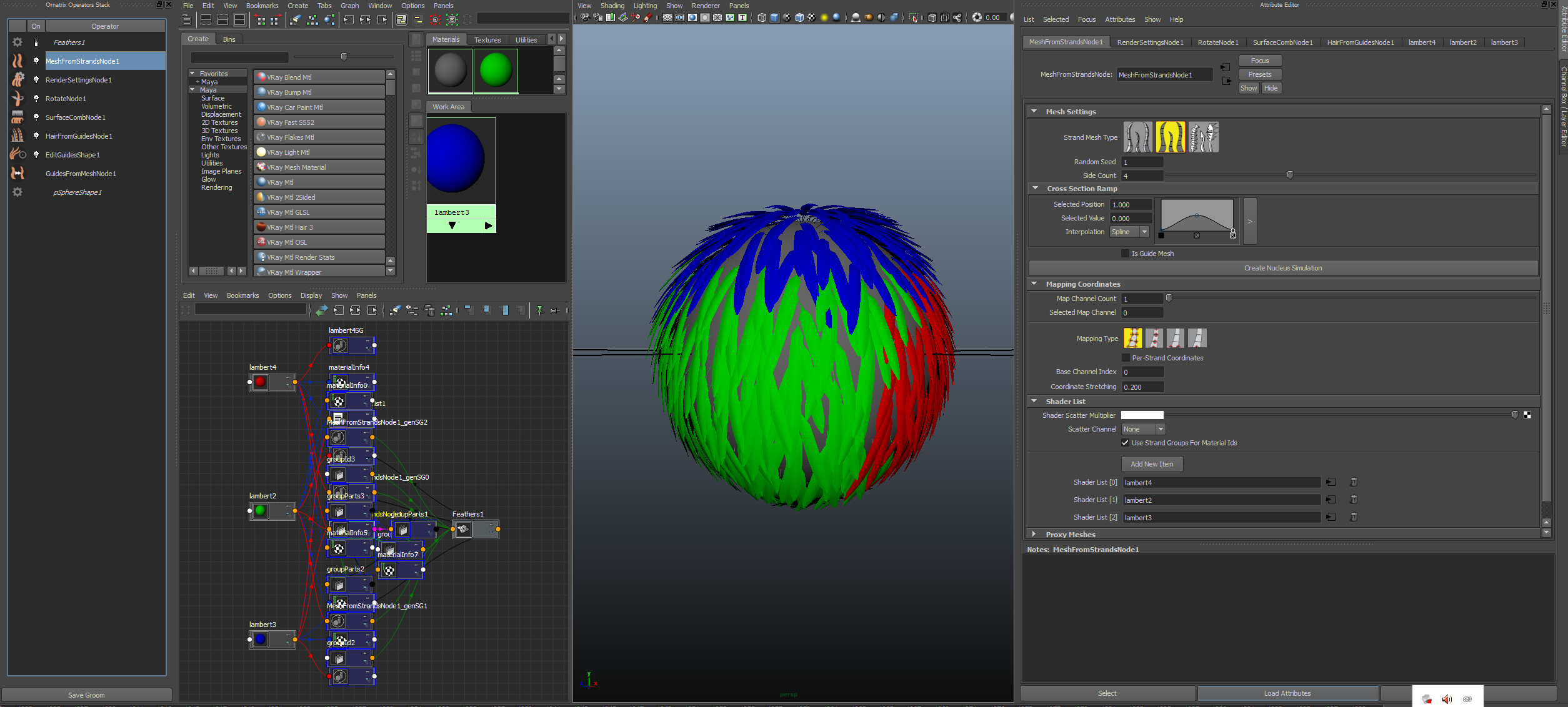

| Here is a bit more of a visual explanation. I want to be able to add another tier of randomization within a strand group vs blasting that strand group with 1 shader. I see this as being done a couple of ways. - first image = 3 shaders with out materialIDs checked - second Image = 3 shaders with materialIDs check... but I want to add another layer of randomness to each channel group. 1. simply add a channel operator to the existing Mesh from strands node so that I can have one for each strand group thus giving me the control to randomize within a channel group. 2. add some type of control to be able to specify the channel the shader is going to - ShaderStackingMockup_01.png 3. Even more powerfull be able to create VRayUserAttributes (this case a scalar) and assign a value on a per strand basis and make that available to vray. Thus letting vray use the scalar to choose which shader to switch to. Maybe this can be accessable in the VRayHairSampler?? There is also a vray texture switch that will soon support VrayUserScalar and that would simplify the number of shaders and allow a simular method of texture switching. 4. something even more creative I haven't thought of! :) does this make sense? | |

| I got you. Well 2) is out of the question, this would totally break the way it all works right now. About VRayUserAttributes, I don't think you can pass functions to them as you are showing in the image (rand(0,2)). I think it expects one of (r,g,b,a),(r,g,b),(r). But using VraySwitchMtl is a good idea, so why not use it with another type of texture, say noise, instead of user scalar? I guess a noise could too provide some randomness for the switch mtl and you could tweak it until it's fine. Also, from your screens it seems you got something working with a VRaySwitchMtl.

| Thanks for the Reply, is #1 an option? that would be great as well.... What you see in the screen grabs are just photoshop mockups so that I could illustrate my question a bit better. The vray user attributes can both be a color and scalar. The per strand random function was more of an ask as you guys would have to support some basic scripting functions to attach a random number to each strand...and expose it as a vrayUserAttribute (color or a single value). the swtich material expects a int or an approximation from a texture map which not impossible would be difficult to control. I am going to see if Vlado can get to the strand ID suing the vray hair sampler as there is a Texture node that can randomize within a range based off of IDs vray has access to. I'd love to keep the control in the procedural nature of things as that's the whole power of your system. :) The only way I can achieve this now is to create mutiple hair systems and cull out the unwanted hair generation in the hairfromguides node. This is not ideal as there is more groom continuity management across hair system... getting them to blend etc..... thanks for looking into this and maybe consider it for a larger release as having a better granular control of strand texturing would be great..... in the mean time i'm going to play around with noise functions and masking in other ways. | |
