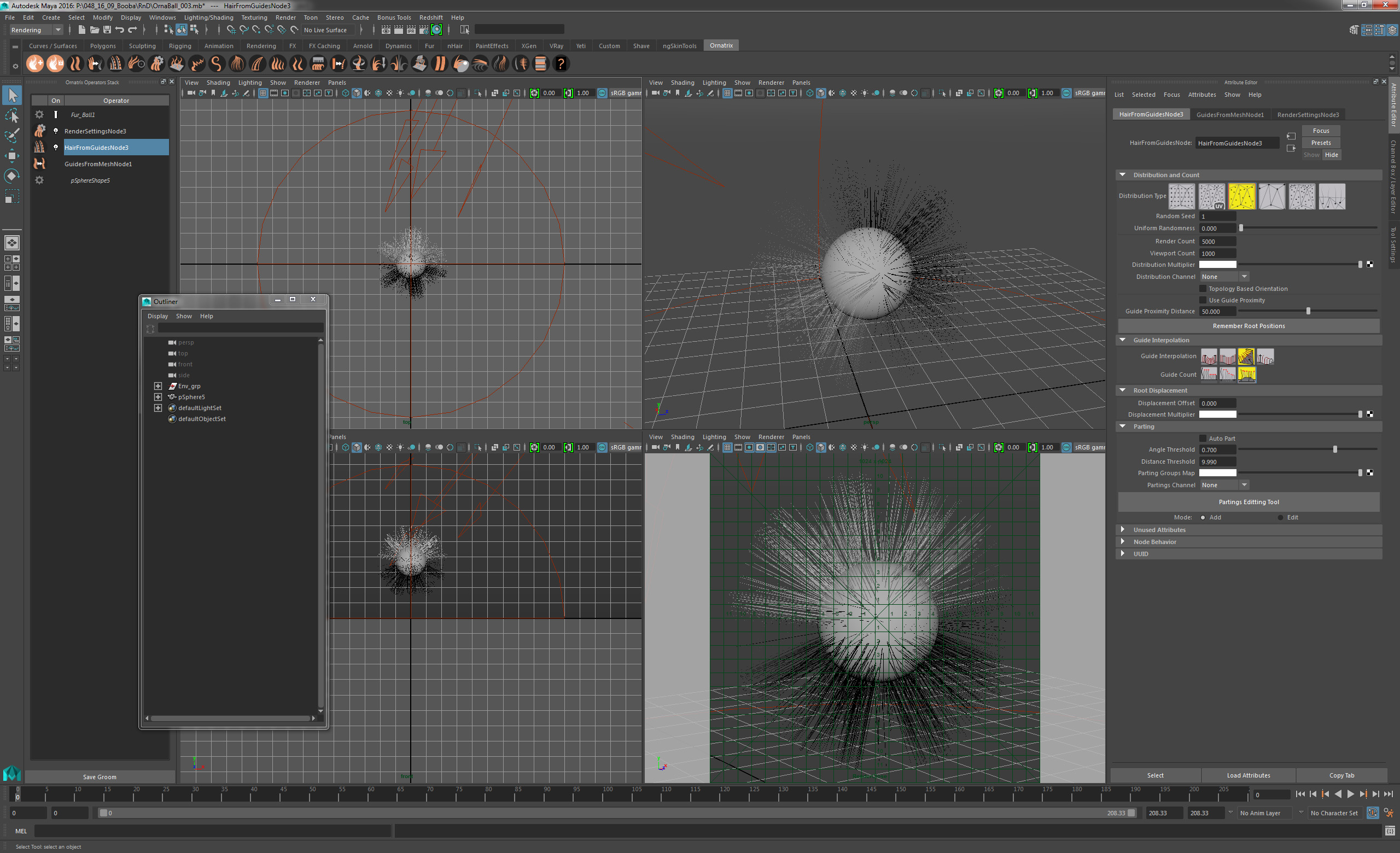

I'm having a lot of trouble with a very simple groom so I decided to do some tests. I created strands on sphere and rendered with different interpolation types. I can't get a round sphere, only spikes. What am I doing wrong? |
| Found it, Randomness attribute was .2 Attached Files: |

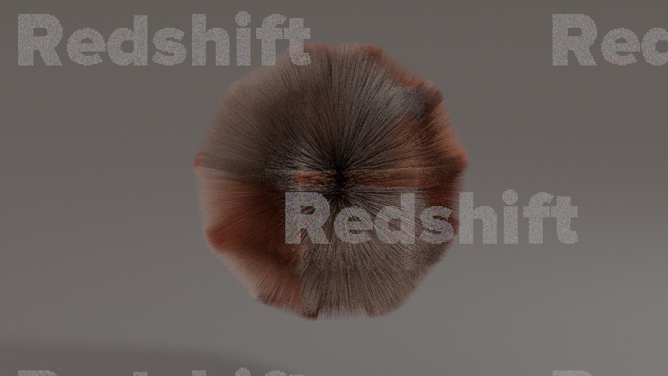

Anywayso, removing randomness made the sphere nice and round but it had 300 guides - way too many to be managable so I dropped it down to a more practical 30 and I get the same spikiness in the hairs. guides are set to uniform distribution, interpolation is affine, 3 guides. Attached Files: |

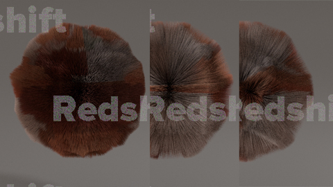

| no map is present seems to be happening on all interpolation methods except for polar - polar works fine on a sphere but does not work well with UV mapped geometry Attached Files: |

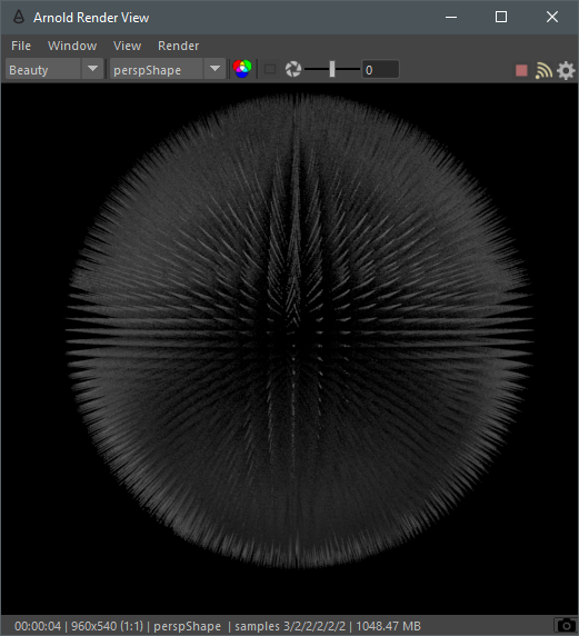

| it was just a default sphere, add hair, nothing extra. In relation to the cuda error - I can get a hold of a Quadro K4000, but would a card with only 3gb memory be enough to simulate a toony character with 800 guides at detail level 20? Attached Files: |

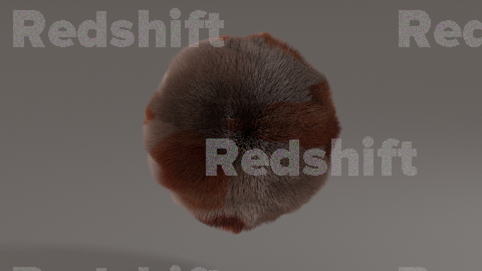

| HI, For the sphere, do you want a rounded and uniform result right? In the image below I get the result you are looking for by changing the Distribution Type to Uniform in both: GuidesfromMesh and HairfromGuides. I'm not sure about the Dynamics but I will ask the devs. Let me know if that help you. Attached Files: Jeordanis Figuereo (Product Designer. EPHERE Inc.) |
| The guides were on uniform but hair is on random. Are you saying the other modes are broken and I can't use them? Why doesn't it interpolate as expected? |
| Hi, Magilla, all the distribution methods should work well for you. What I'm saying is that if you want your hair without any variation or randomization those settings works best. Can you give me an idea of what you are trying to achieve exactly? Jeordanis Figuereo (Product Designer. EPHERE Inc.) |
