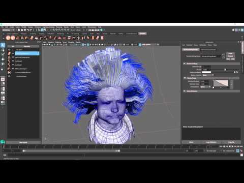

You can create an strand group in the EditGuides Operator with the hair you want to be shorter, then use the Lenght Operator to control the lenght of those strands. Here is a tutorial about strand groups: 9o51lwSwTE4

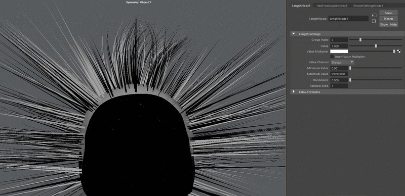

I thought you wanted something like the gif.
Am I wrong?
yes, wrong - that is one hair length, I want short hair and long hair from the same strand.
Essentially the only way I can tell how to do this is to create a second bunch of strands and shorten them, give them a channel value and use that channel to distribute the shorter (or longer) hair. this is a lot of manual work that gets really messy very quickly.
In the gif I'm controlling the length of two differents groups of hair in the same groom. Isn't that what you meant?

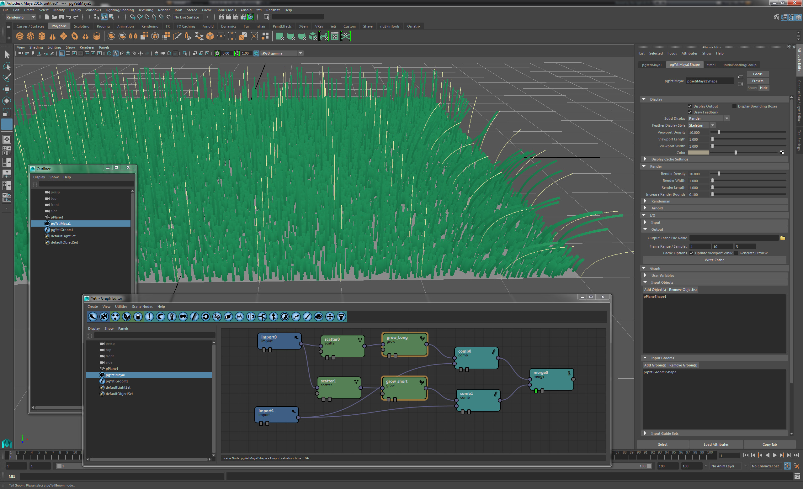

Apologies for using a competing hair product but it was the easiest way to describe what I am trying to achieve. There are two "HairFromGuides" equivalent nodes which have their own specific length nodes, they get merged together and they both react to the modification of the guides, one simulation will move both lengths of distributed hair. At the moment the only way i can see to do this in Ornatrix is to have two completely seperate stacks.
