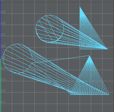

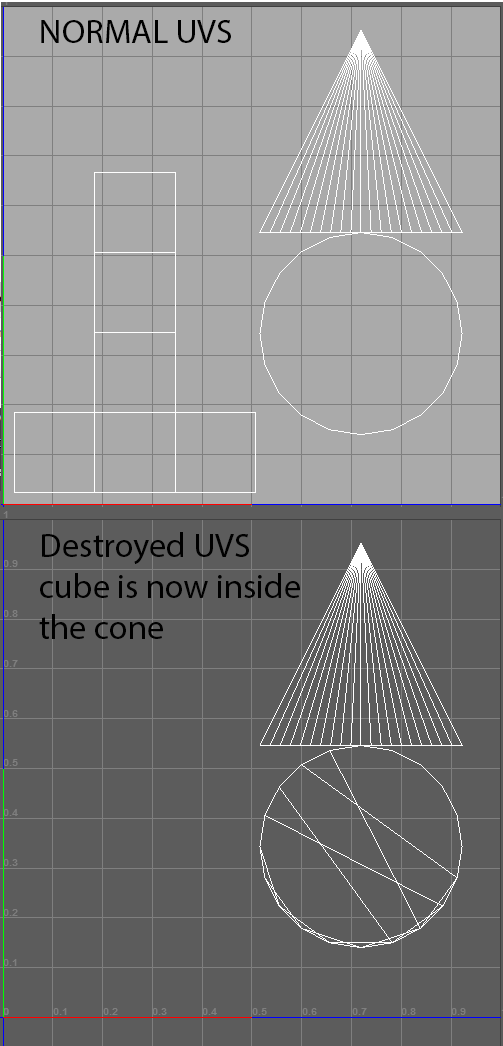

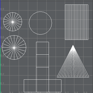

To test this I made a cube and cone to add as proxys as it was hard to tell with the hair strips if they were swapping in correctly. I moved the uvs around and game them a basic black and white texture. They worked correctly in the viewport as a white cube and black cone. When I added them as proxy meshes though they both appeared black.
What i found is that the mesh from strand rebuilds the uvs of a random proxy mesh to try and fit within the UV shell of the other one. The hair cards rebuilt their uvs to fit within the first hair proxy uv shell so they use the same texture space. same thing was happening with the cube and cone.
So basically the mesh from strand feature is destroys the uvs from all but one proxy mesh which makes hair card generation difficult. I appriciate any help.
