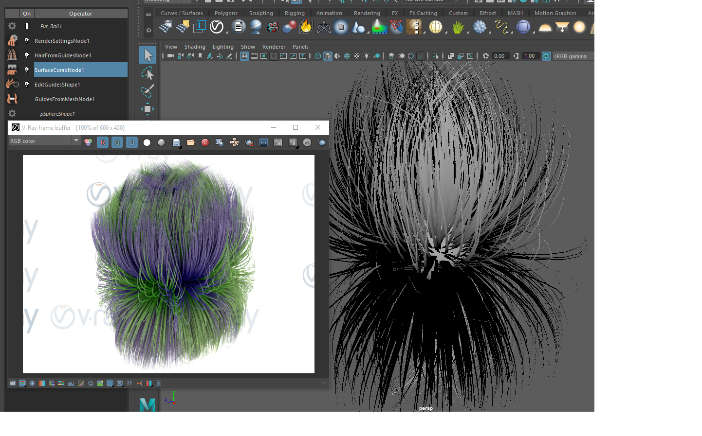

Hi, Is there a way to get a render in vray with hair texture from uv coordinats, without using MeshFromStrands ? Looks like it first inherenting the uv, with MeshFromStands on when rendering. But in the viewport i can see the texture currectly assigned whitout the modifier. and in render it is removed :/ Image attached. Another thing, is there a solution to the displaying of the hair ? Looks like some of the shows the backside in the viewport. Best regards Simon Attached Files: |

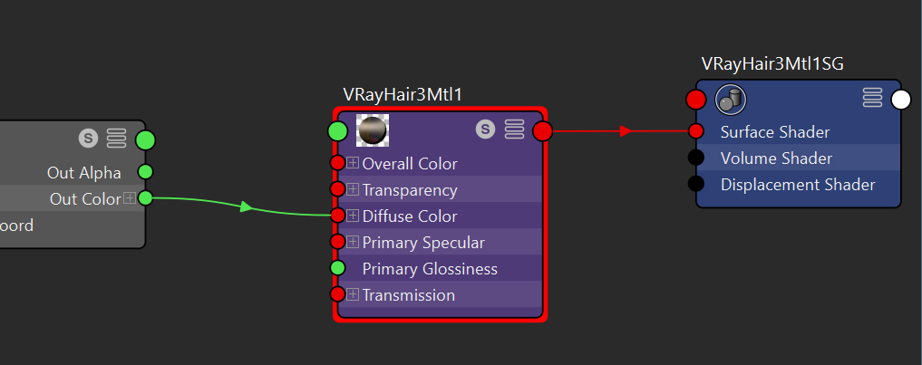

| Are you connecting your texture map to the Diffuse Color slot of the VRay Hair Shader? Jeordanis Figuereo (Product Designer. EPHERE Inc.) |
| Have tried in both Overall and Diffuse slot, together and separately. Do i have to assign it i some special way ? Right now i have selected the hair and assigned it that way. |

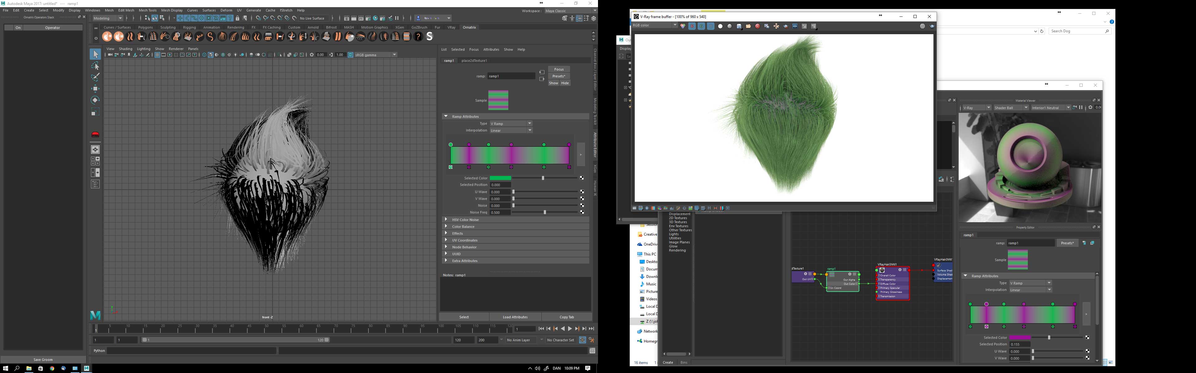

| I don't think you need any special steps to make it work. I just assigned a Vray Mtl Hair 3 to the hair and then I plugged a texture to the Diffuse slot and is working fine. See the attached images. Attached Files:  Jeordanis Figuereo (Product Designer. EPHERE Inc.) |

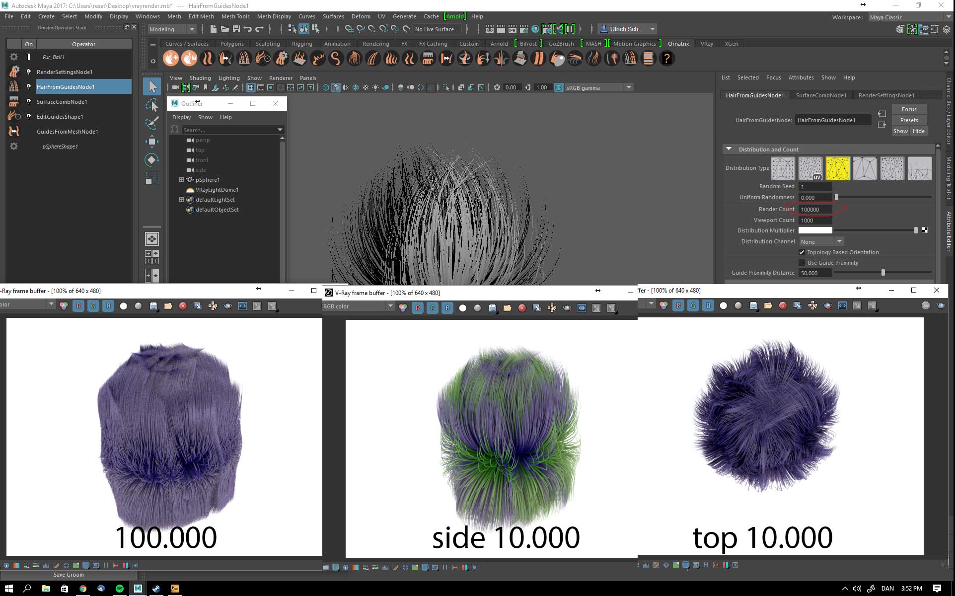

| Hi Logikoma, Thanks for the file, when i render it with 10.000 hairs i looks fine, however the color dont stick when orbiting around. And when i from "side" view just increasing the count to 100.000 it's all purple Attached Files: |
| Hi again, Thank you, I was able to reproduce this problem. I'm not sure if the problem is on our end or with VRay, but I reported this to the devs for investigation. I will keep you posted. Jeordanis Figuereo (Product Designer. EPHERE Inc.) |

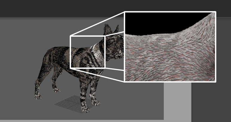

| This is the result of my tests:  I'm attaching this scene so you can test it. Connect your own texture, render the scene and get back to me with the results. Jeordanis Figuereo (Product Designer. EPHERE Inc.) |
