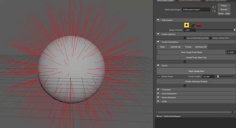

Hi Guys! I must be missing something or doing something wrong
I just created (example) a sphere and add a fur ball than I just want to delete some strands, than I've selected it and pressed "delete selected strands " buttons but nothing happen and apears " //Error: Unable to get hair node"
do you guys knows what Im doing wrong?

Hi Felipe.
I just tried and it is working as spected here as you can see in the attached gif. Can you share your scene?

Unfortunelly not, here we dont have internet on workstations, we just have internet in laptops =/ but after some attemps I turn off the ornartrix plugin on windows / plug-in manager panel and turn it on again, close and open the maya 2016 I dont know why its worked =Z
